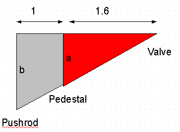

It's all to do with similar triangles:CastleMGBV8 wrote:Chris,
If I'm correct if I remove 50 thou from the posts snd remove 48thou of shims ie 98thou i need to divide that by 1.6 (rocker ratio) which will indicate a shortening of the push rod by 61.25thou
If a=98thou, then similar triangles give you b (which is the amount to be taken from the pushrod) as 98*2.6/1.6 = 159.25 reduction. Add on the 15thou gives 174.25 reduction.
You need to think of the valve stem as fixed.
Make any sense?
