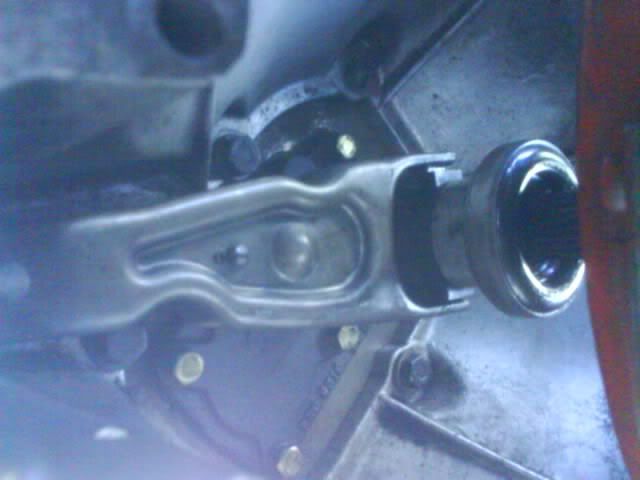

taking no chances I decided to drop the gearbox out of the SD1 yesterday to inspect if there was oil on the flywheel causing my clutch slip. I spoke with Tony (thanks mate
) and found out that the pivot pin needs no washer behoind it . My "helping neighbour" had put a big ass spring washer behind the pivot pin! This xtra 4mm has cause my clutch to not quite grip properly.

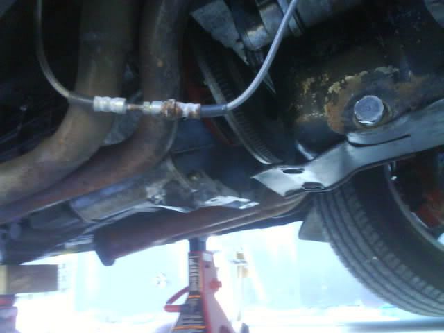

So again jacked up the car, remoed exhaust system, disconnected driveshaft, removed slave cylinder, removed bellhousing bolts, removed gearbox mounts (which I need new rubbers for!) then man handled the gearbox back off the block and had a good look inside. Removed the clutch folk, pivot pin and the problem, the washer!
Re-installed pin, re greased and hooked up the clutch fork and put eveything back together.
3 hours from start to finish! Not too bad i dont think, then agan i have had plenty of practice.

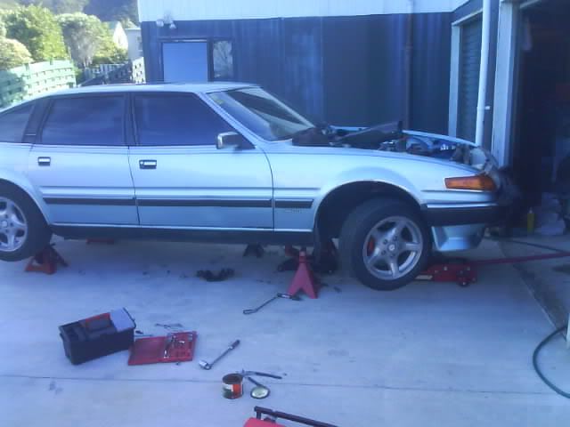

just some pics of the car and box.
