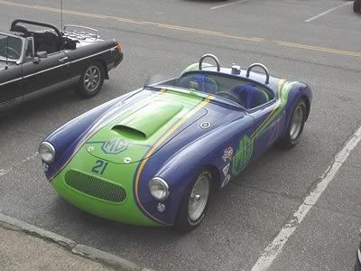

I've got an MGB V8 with a Chevy auto trans, Al6, Mallory electronic stuff, Weber 500, WON nitrous system, lots of gauges ,bells and whistles. The MG owners club love it.
Mind you, when I go to Bromley not many of the Tartan rug and picnic basket MG mob want to talk to me. And the V8 register seem a little stand offish when I go to Silverstone.
But what the hell!!
Build it, test it, rag it.....
