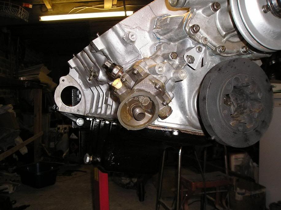

Pocket rocket
Posts: 256
Location: Hawkinge, Kent
Post by Pocket rocket »
Hope you can see the oil pressure light sender - the oil pressure gauge is connected to the port with the yellow bungImageImage

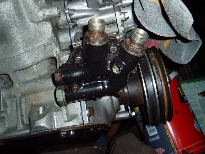

tetlow
Posts: 323
Joined: Tue Nov 28, 2006 7:58 pm
Post by tetlow »
Thanks for the help.
I will compare it to mine. I have a remote filter though.
Regards
Pocket rocket
Posts: 256
So do I but that only involves a blanking cap where the filter originally sat. The outlets for oil pressure sensors will be the same (unless you have fancy in-line ones with the remote filter)
tetlow
Posts: 323
Post by tetlow »
My set up is far from fancy but I do have a remote filter.
The housing does not have two take offs like yours but there are two plugged ports .
Can I use either of these?
Pocket rocket
Posts: 256
Can't think of any reason why not :)
tetlow
Posts: 323
Post by tetlow »
Can I use either of the ports to the left?
The open port is the pressure gauge take off so I assume the lower plup would be the one to use. :?:
Regards
Posts: 5077
I think the lower one has the pressure relief valve in it.....
The best bet is to take it off, and try to figure out how it works, as it might not be possible without a T piece. This was my finding with my Mocal remote filter setup.
katanaman
Posts: 3081
Post by katanaman »
lower one is definitely pressure relief as chris says
