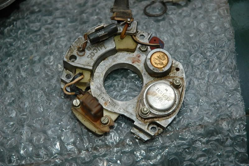

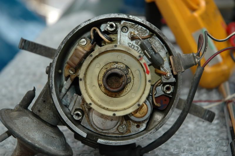

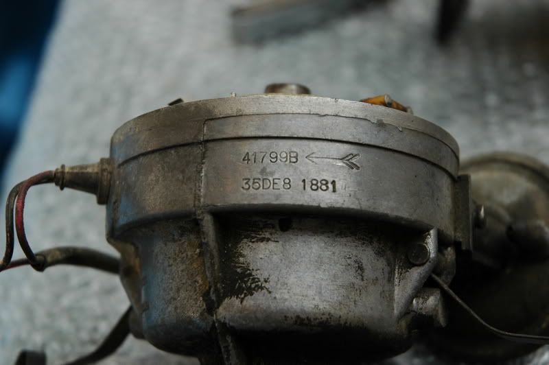

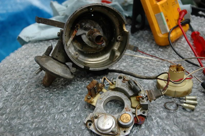

Descided to pull it all out again today to check what parts I have and find out what im going to need
It turns out I have the 35DE8 version so I can now tell exactly which unit im going to need, iv been looking on the Aldon website as they seem to have a good listing for Lucas units, but when it comes to the coils they only list 1 model that being the the 12v 1.5ohm version for 8 Cylinder Applications just wanted to check that this is what ill need ?
So my plan is to gut out the dizzy and fit the new Pertronix internals then remove my old ballast resistor and old low voltage coil for a directly wired 12v coil, does this all sound ok ?
Took a few pics today as I was unsure on what parts I had got but worked it all out now - I think :D
