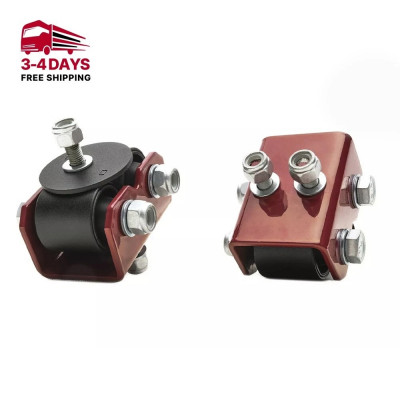

Or you want something more rigid, this style of mount with 2 rubbers is common for Jap vehicles. Whether nylon, or using 2 rubbers. Some look like leaf spring mount rubbers, that sort of thing
https://www.aliexpress.com/item/1005004638662611.html
https://www.ebay.co.uk/itm/365458652862?

Thanks for that, those sort of things look ideal and even better, they’re something I can make instead of buying.

Doubling up like that should allow you to make them very stable.
Up to you whether you opt for a nylon or rubber solution.
As said, some leaf spring bushes look like they might be usable, or something like this ( depending on dimensions )

Thanks for the reply but they look like the ones I already have - I expect there’s a difference in the stiffness of the rubber between suppliers but that’s not something you can tell until they’re fitted.
Yes, I found the polyurethane ones on here but unfortunately they’re different and would need new engine and chassis brackets, assuming they’d fit in the space available.
I’ll just make some with metelastic shock absorber style bushes, it should be easy enough.
