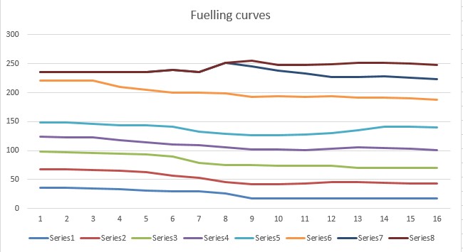

I had a look at the mapping values and plotted them out,
normal
The horizontal axis is RPM, vertical is 'load'. They look typical and as there are no sudden changes I don't think they will be contributing to the trim movements.

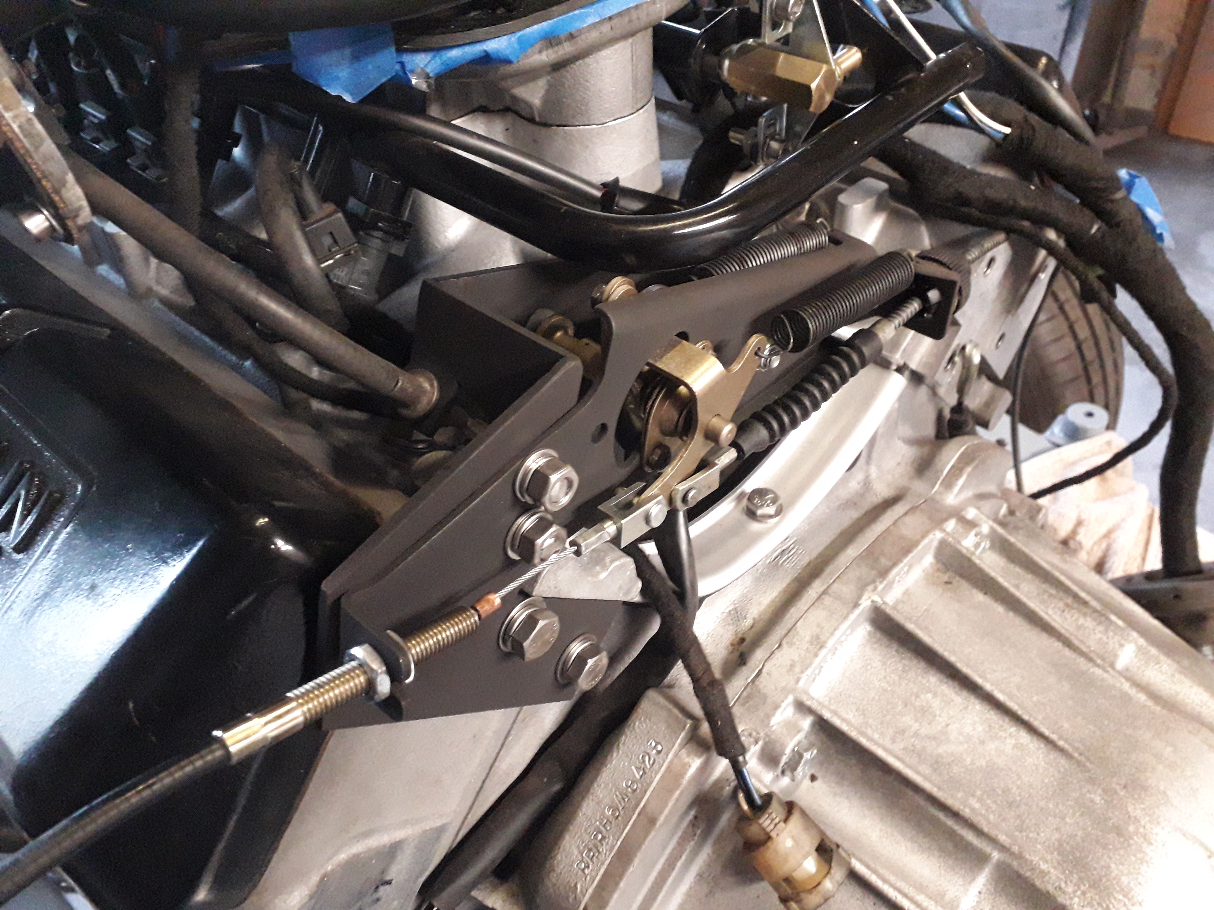

So I made an adapter which gave more throw and accomodated kickdown -
This used part of the original system and a longer lever to acutuate the ACT throttle butterflies. But I didnt get the length of the lever quite right so currently getting only 81% throttle which until recently I thought this was enough but plainly it isnt so it will be interesting to see how much more performance I will get when I have this corrected.
