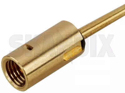

We didn't think to take photos of the needles but they screw up and down in the needle mount/the threaded brass bit using a tool with a slot, not a hex key and are sprung loaded so if you pull them down they pop back up till the little 'circlip' thing (the black bit next to the grub screw slot) touches the bottom of the needle mount/the threaded brass bit. As best we can tell they'll look like this
We've removed the grub screws but the needles seem stuck in place - should they slide out or is force needed?
