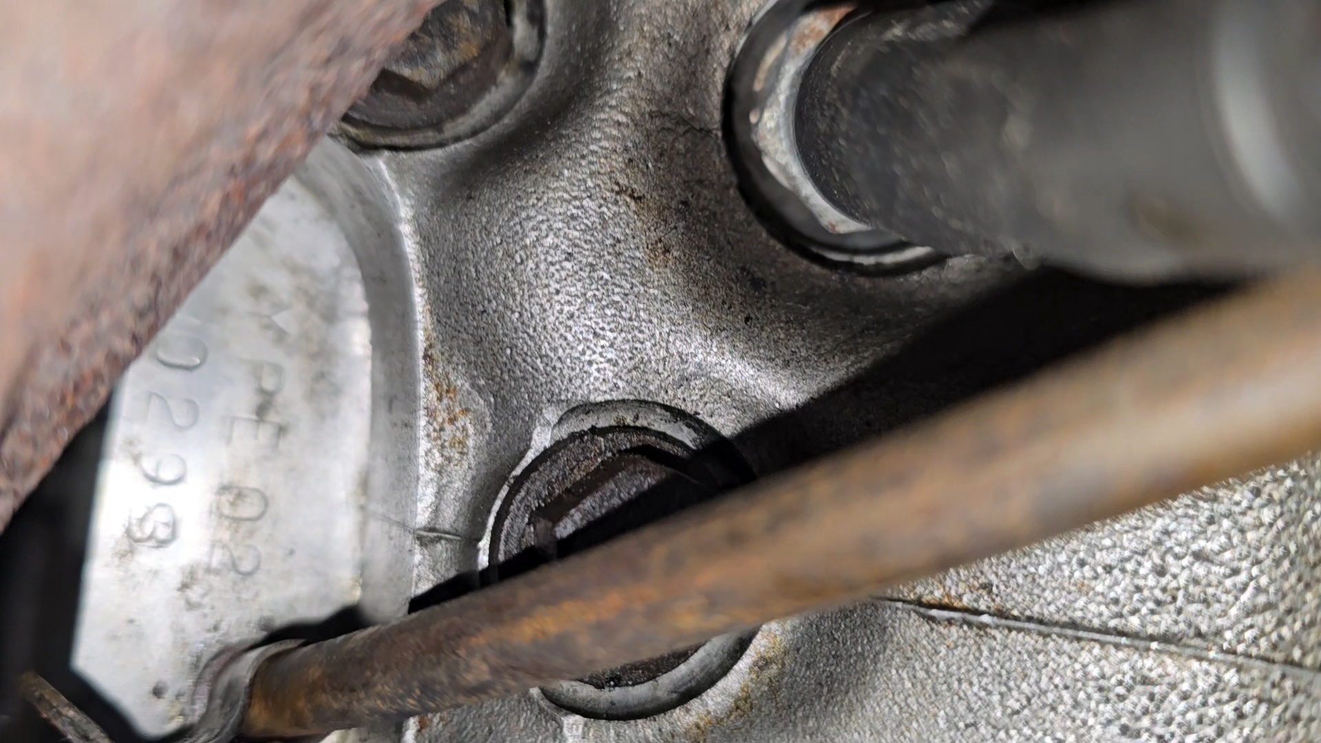

Can anyone tell me anything about this engine please?
84000837A
84000837A
Re: Rover V8 Engine Numbers Updated:
Google is your friend
https://www.v8register.net/FilesV8/V8%2 ... .11.07.pdf
In the first batch of engines P5 3500 10.5:1cr 1967-1973
