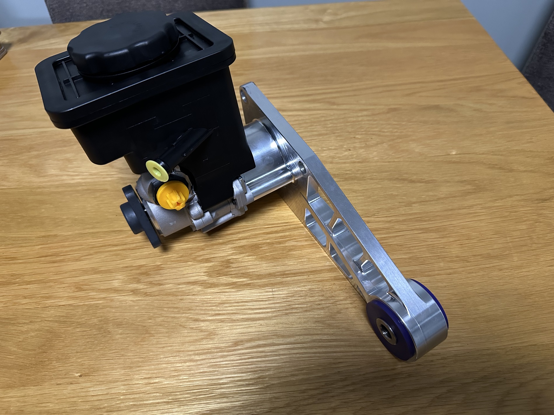

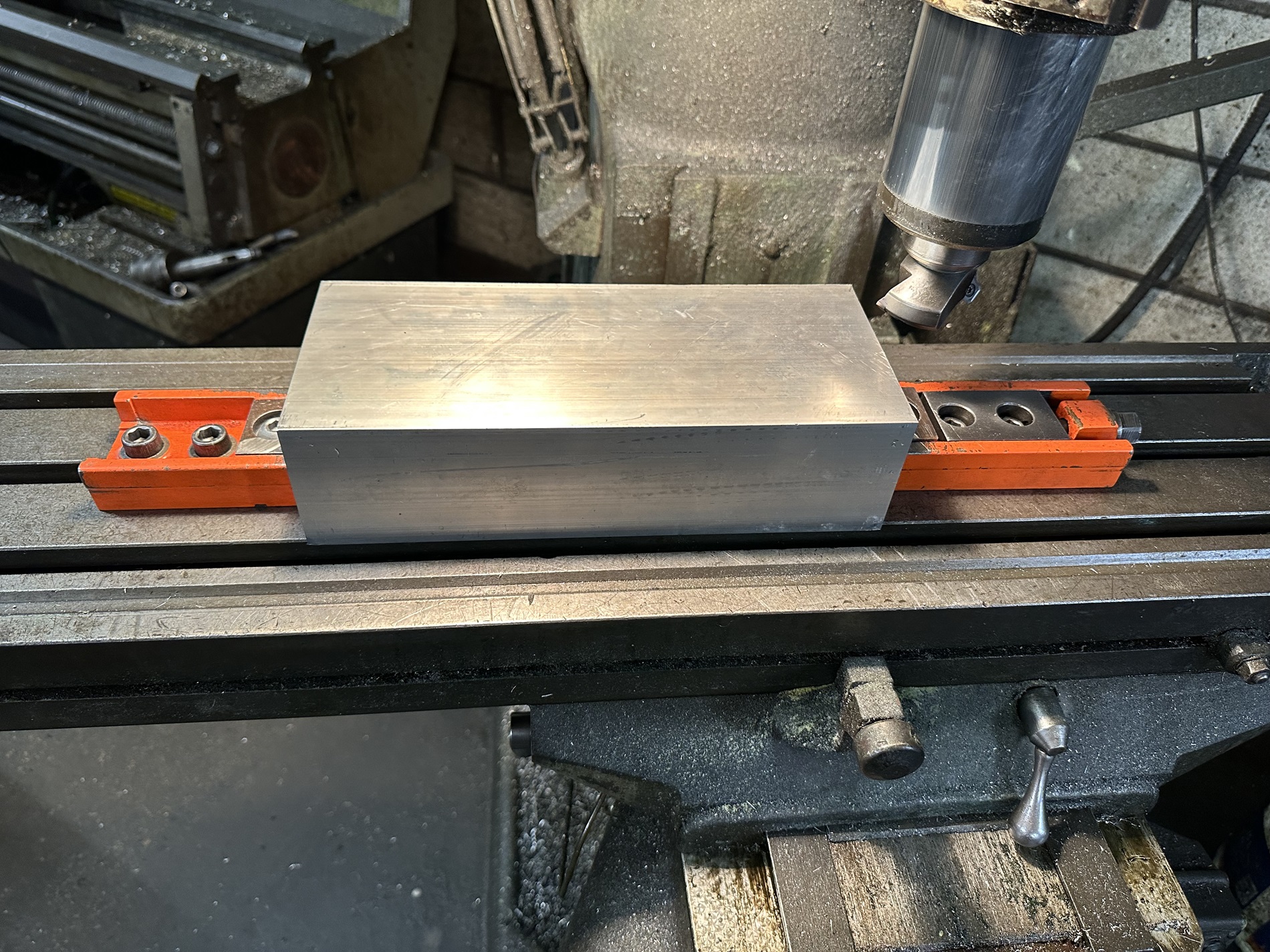

Not done anything about inlet air temps yet, but I have been trying to fix an issue with the power steering as it's too heavy.
The bracket the hold power steering pump doubles up as a torque arm to try and stop engine twisting.
I've already made one new bracket to take a120 bar BMW pump as opposed to the 100 bar Peugeot pump I'm running at the moment.
No pictures taken making this and it's probably just as well as I f#cked it up wasting a big chunk of time and aluminium :oops:
Somehow the angle the new pump sat at was wrong so I measured the difference, bought some more ali and started again!

Posts: 5078
Re: My V8 Sierra project ..... maybe I will finish this one !
Nice!!
Interestingly I've never had a mismatch between pump & steering box, although it's always been a Rover or Land Rover pump and a Land Rover or Freight Rover steering box.
Mark
Posts: 383
Post by Mark »
Cosworth rack and pump are meant to be 100 bar, trouble is the steering was horribly stiff with a 100 bar Peugeot pump :?
I'm hoping this one doesn't blow the seals in the rack...
Posts: 4064
I used whatever was on my LS engine and it works fine with a Sierra rack
Nice machining work there.
