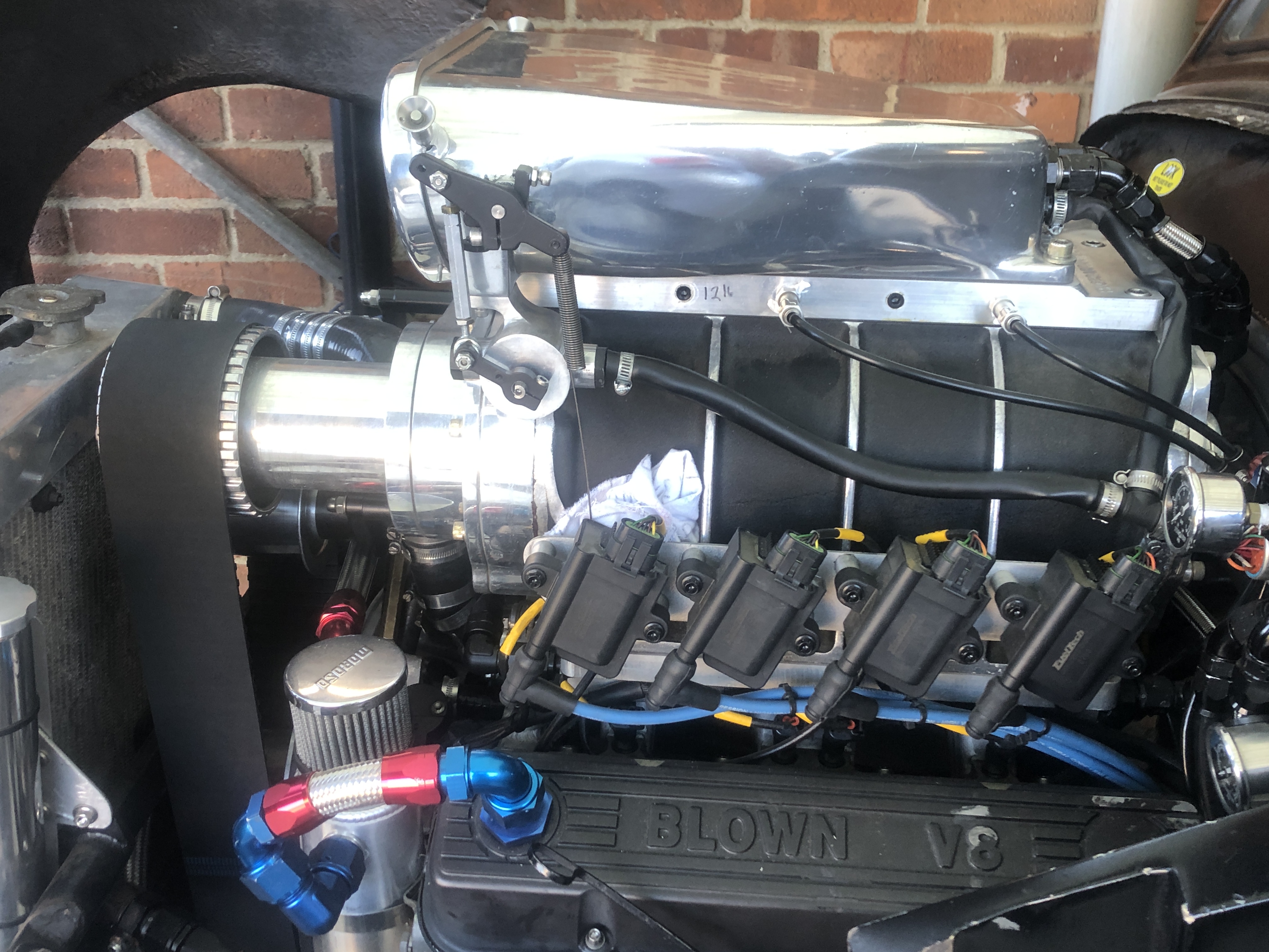

I have it,
I’m running a fair bit of boost, I have 8 injectors in the “hat” and 8 in the manifold. You can see the water/meth injectors above the blower.
I’m using a fuel tech 550 to “run” everything. Under boost, most of the fueling is done in the manifold, the water/meth keeps the rotors cool and lubricated.
- Posts: 4075
Re: water meth on a blown v8
This is the thing though.....as he's carb, he already has fuel cooling the rotors.Blown v8 wrote: ↑Sun Nov 12, 2023 7:18 pm I have it,
Although all fuel/meth would wash any coatings off the rotors over time where they have it. I'd say water might well too, but perhaps to a lesser degree.
