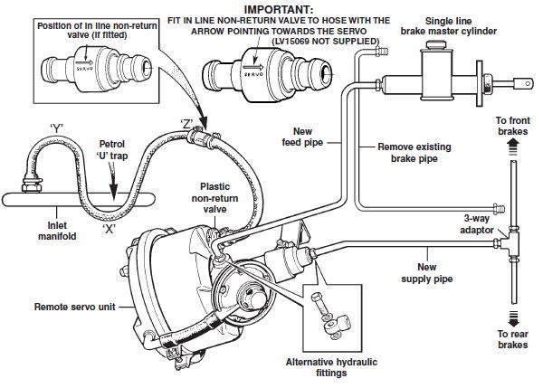

The remote boosters from older cars can be positioned 'relatively' anywhere - they are usually 6" or 7" diameters. Maybe could fit one under the dash? Hydraulic line from your clutch master in - then line out into your clutch slave. Would need to ensure there is enough fluid volume.

SuperV8 wrote: Wed Nov 08, 2023 11:16 am Crickey - quite a journey!
A Mini or Alfa GT booster in the boot or in a wheel well will fit that bill nicely, but you may struggle with MOT and Insurance etc.
