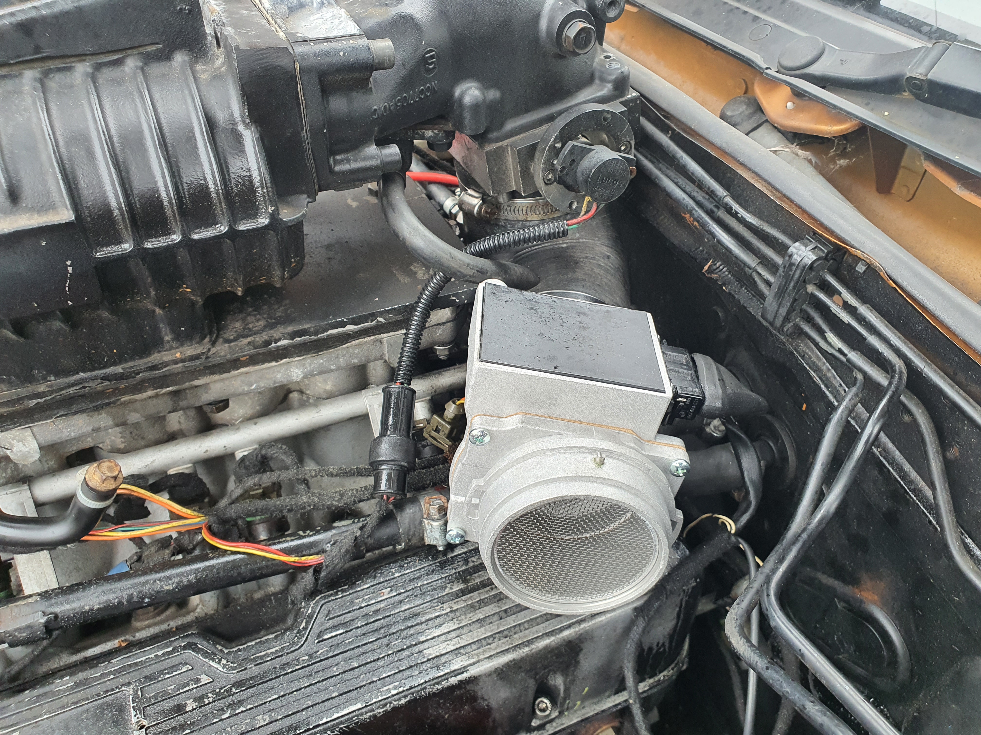

The MAF is installed before the supercharger, with a k and n cone filter attached to the intake side of the maf.
Idle is currently at around 1100rpm when cold, then once up to temp idle is around 850-900 rpm

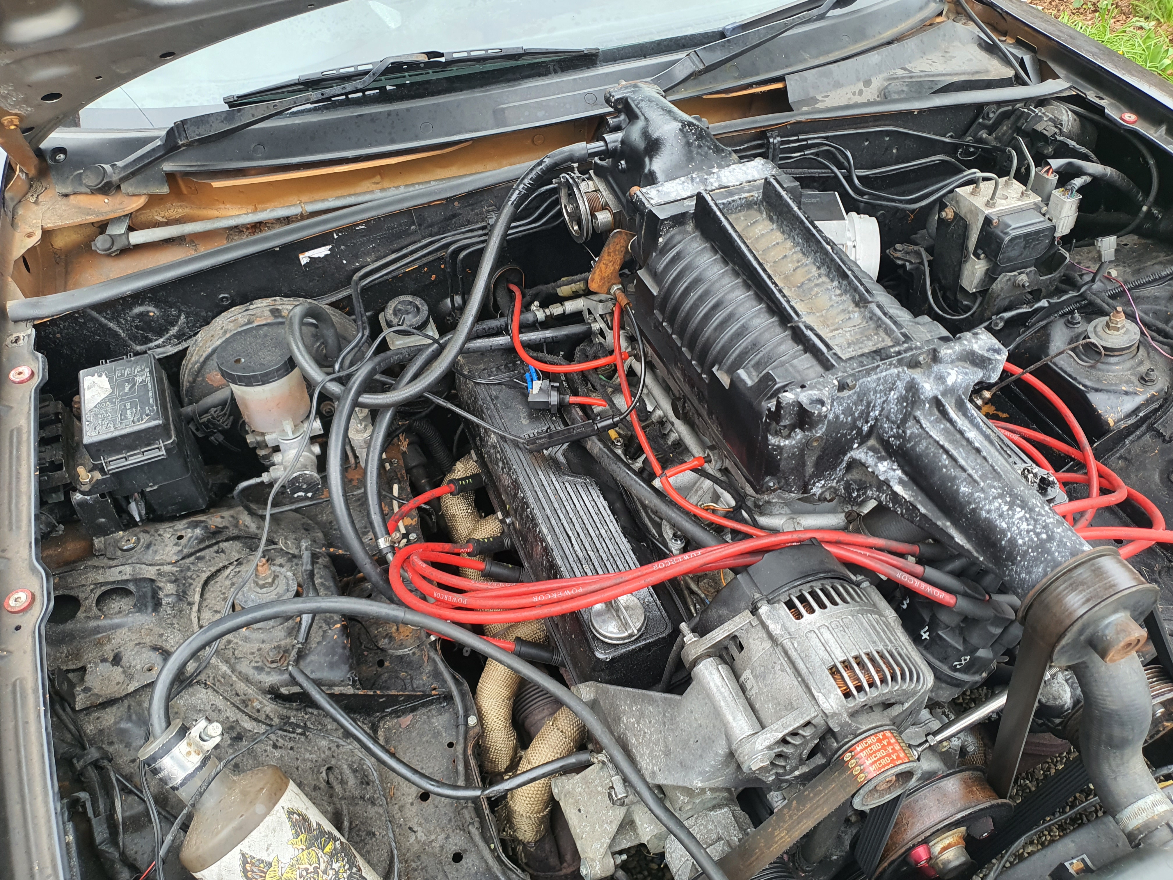

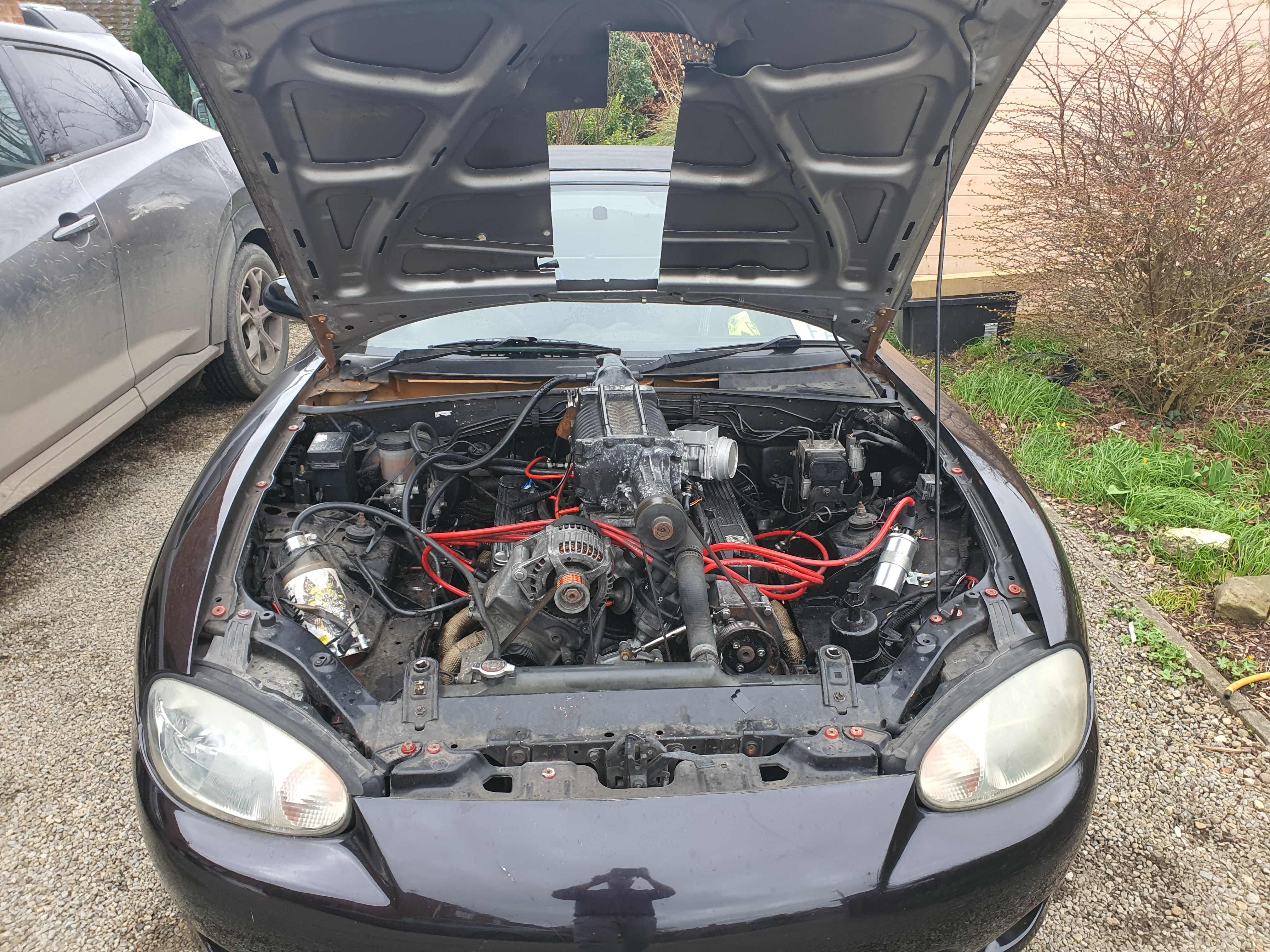

Please see attached pics of install
Rowan
Rowan

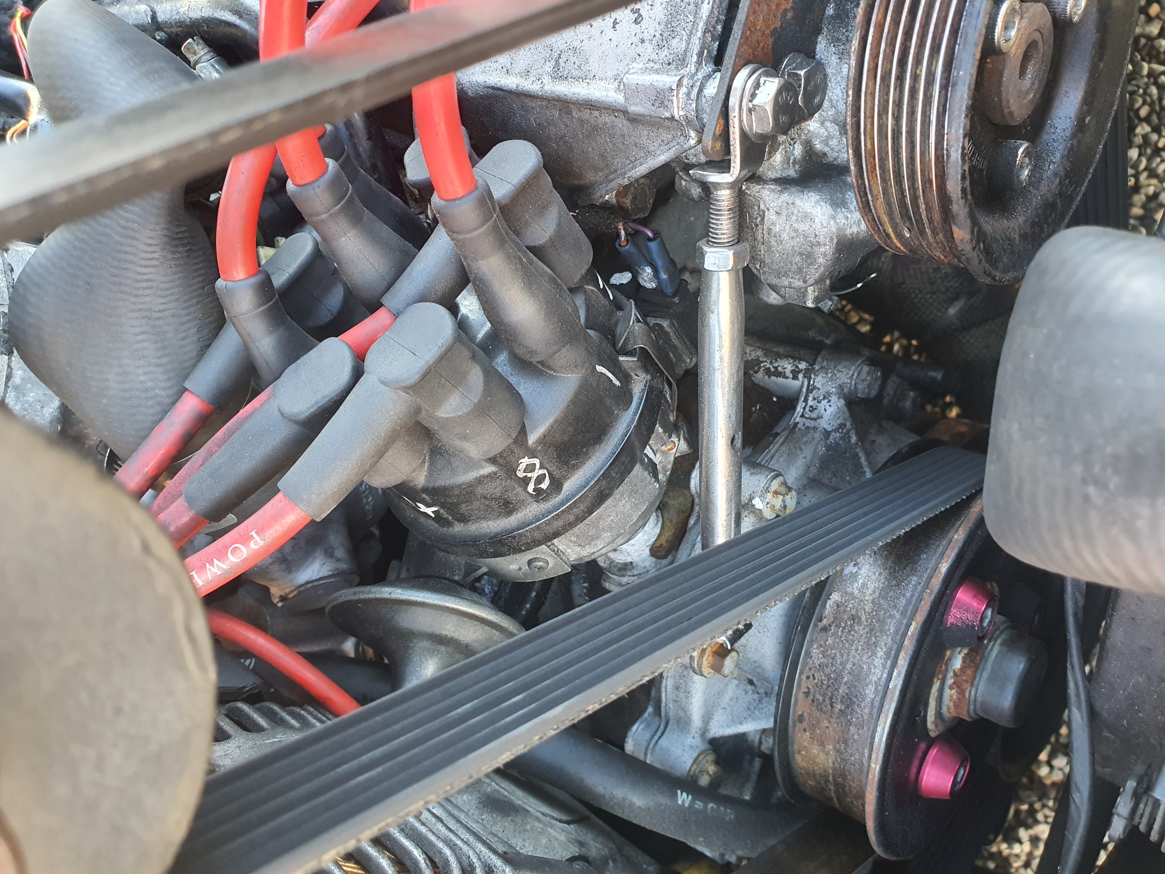

Checked the dizzy cap and all plugs are going to where they should be.
I remember the guys who sold it to me mentioned about the dizzy cap being rotated, they have written the cyl numbers on the cap, not sure if true, the garage was not pleasant, seemed very dodgy so questionable
Please see attached. Hopefully if there's anything wrong with the cap someone with a trained eye can spot it.
