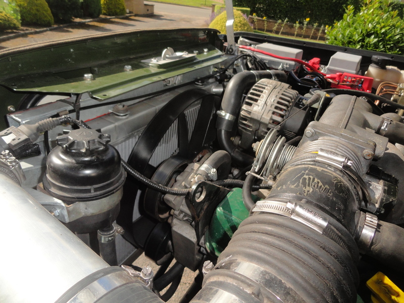

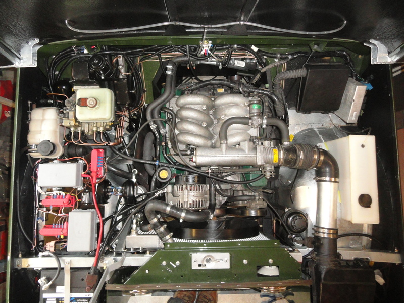

Your spec will indeed give you a nice short engine. I have a Thor 4.6 in my Series Landie, and I went for the distributorless combination for the same reason. In fact my engine is far enough forward to clear the footwells, and still have a viscous fan, and the headlights in the radiator grille.
The one part I don't think you've got covered is ignition. There is no distributor provision on the shorter timing cover, so you will need coil packs and some trickery to make them work. You will need a flywheel with a pickup ring and a crank position sensor. You can do it with MegaJolt Lite (I did something similar a few years ago - 2" SU's and Thor coil packs).
It is worth checking out smaller-bore liners, but in reality I think as long as they are top-hat liners, it doesn't matter. If you have 1.75" SU's, you'll strangle a larger engine at the top end anyway, so it won't go mad for power.

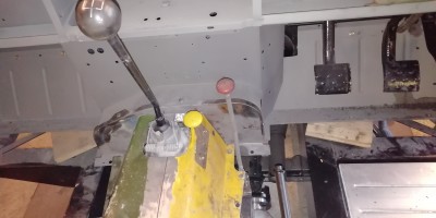

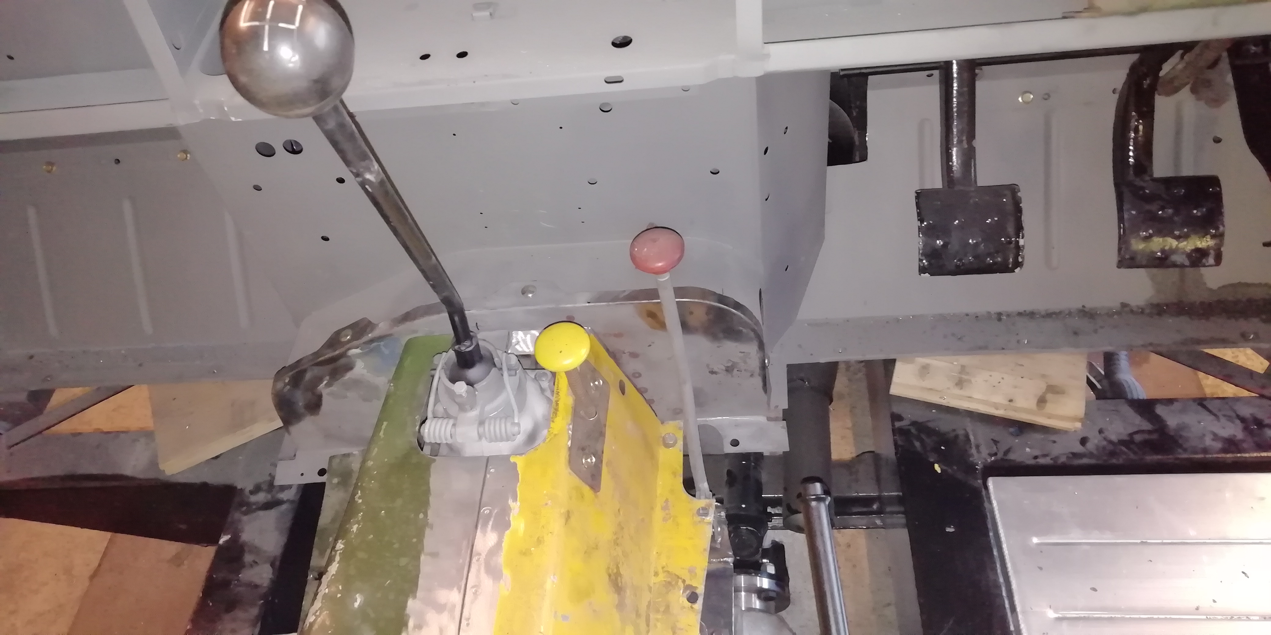

Pics:
You can see that I went to a fair bit of effort to keep the Series gear sticks but use an LT230 transmission. Not an issue you'll have if you keep the Series transfer box.

That is very, very neat. Thank you for sharing!

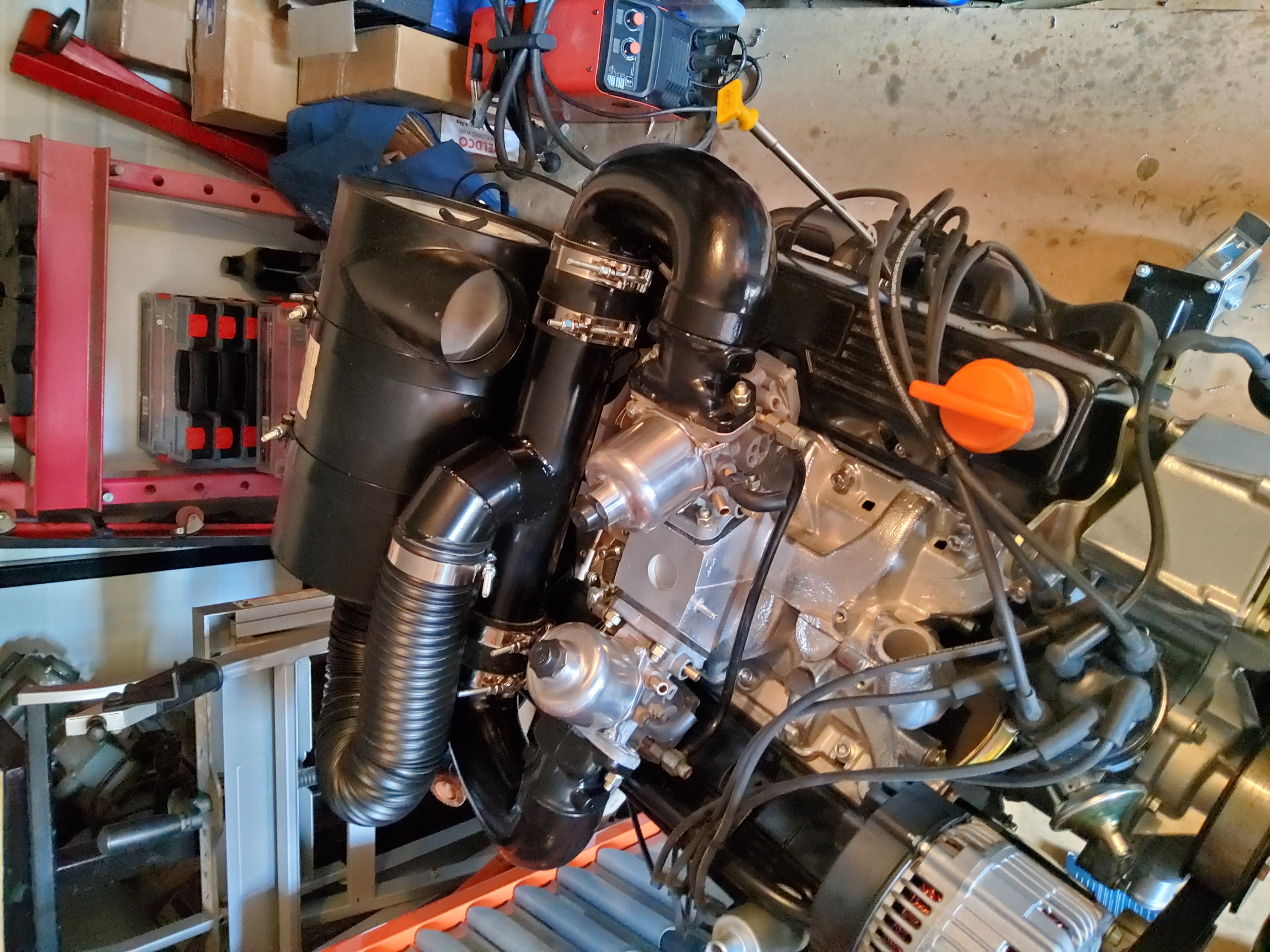

I have just removed a 3.9 interim motor from my 110 which I had been running with solex carbs, cd 175s, I am replacing it with a 4.6 with HIF6 carbs.
