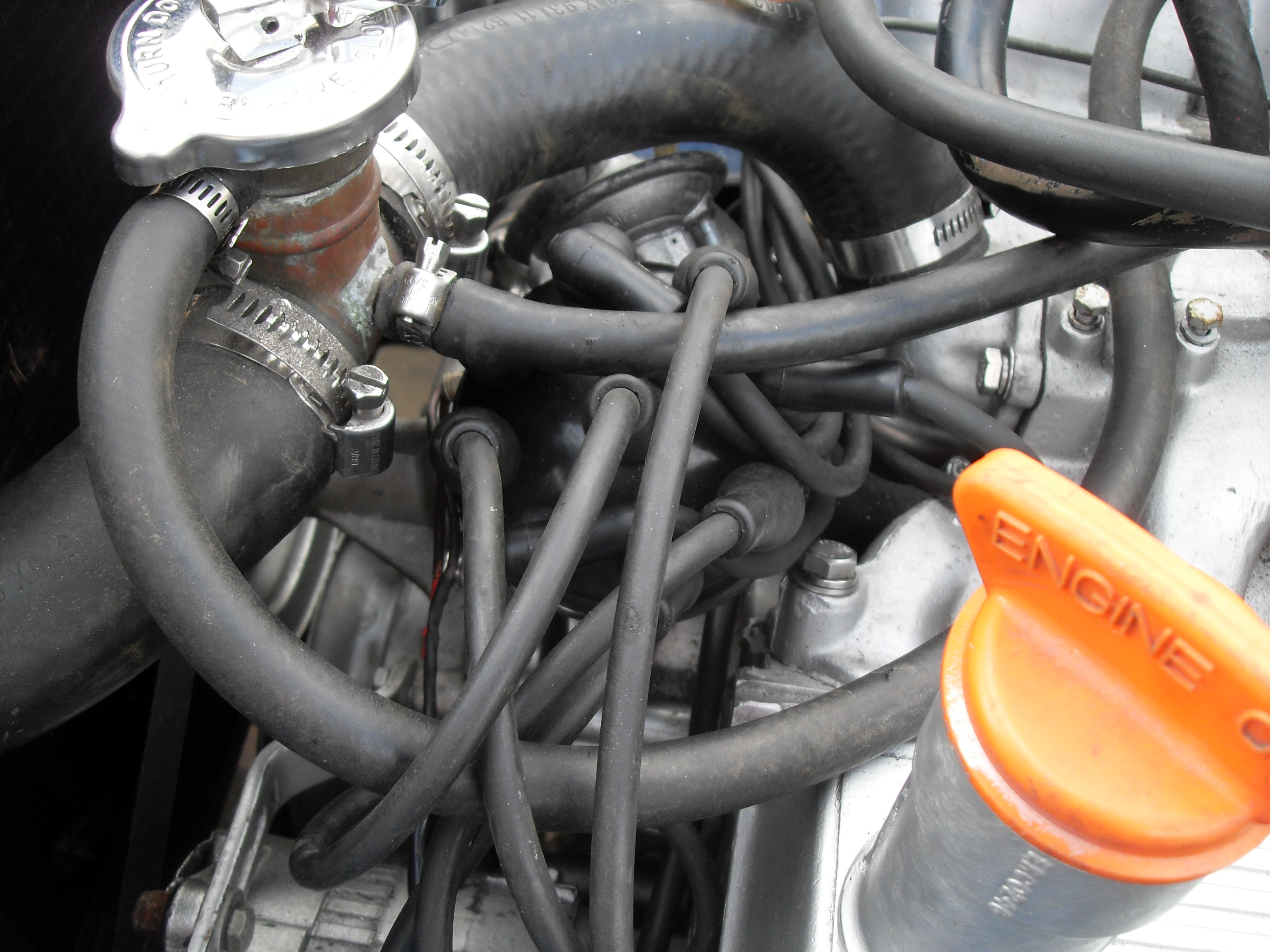

Thanks for help, useful points made but as the thing is trying to fire and it has improved by retarding by a substantial amount and would appear to need more retardation, I am perturbed that something is basically wrong with set up ? The rotor slid in and ended up at 7.00 o'clock, pointing at No.1 with 6 degrees on crank BTC. 45 degrees is one cylinder so will move leads clockwise one step returning dizzy anti clockwise and try again ! Watch this space !

However I think I may have an answer and it is something I have done before, (Ancient Arab proverb, 'Man who is kicked by same donkey twice, never learn') I had put No. 1 lead into the distributor cap to the left of the securing clip and it should be on the right which means the advance/retard is limited severely in one direction but it is possible to catch a spark off the next reluctor which will enable it to attempt to run. However having put things as they should be I have found a very weak spark which I think is the root cause. So, for the princely sum of £120 I have invested in a new dizzy and leads ! If it works I'll let you know !
