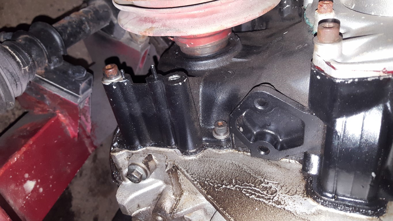

Just noticed my V8 has decided to have no oil pressure... :shock:
No apparent reason. Had it 2 days ago.
So could this be a stuck pressure release valve?
Can I get at that without taking the lump out or taking too much off the motor? I have good access to the front.
This is what I have:
The attachment 20210710_171543 (Medium).jpg is no longer available

Posts: 4080
Re: Help! No oil pressure! 4.6 V8
rich112 wrote: Sat Jul 10, 2021 5:56 pm So I dropped the oil, (black and smelly) and took off the oil pump cover.
The surface doesn't look good. :cry:
I don't know if the relief valve piston is in the right place?
20210710_182901 (Medium).jpg20210710_182908 (Medium).jpg20210710_183000 (Medium).jpg
Undo the big bolt on the left and pull out the spring and plunger, which should be moving freely.
Also verify whatever you are using as a gauge is working correctly. Wear and scoring would be typical and not a reason for "no" oil pressure.
