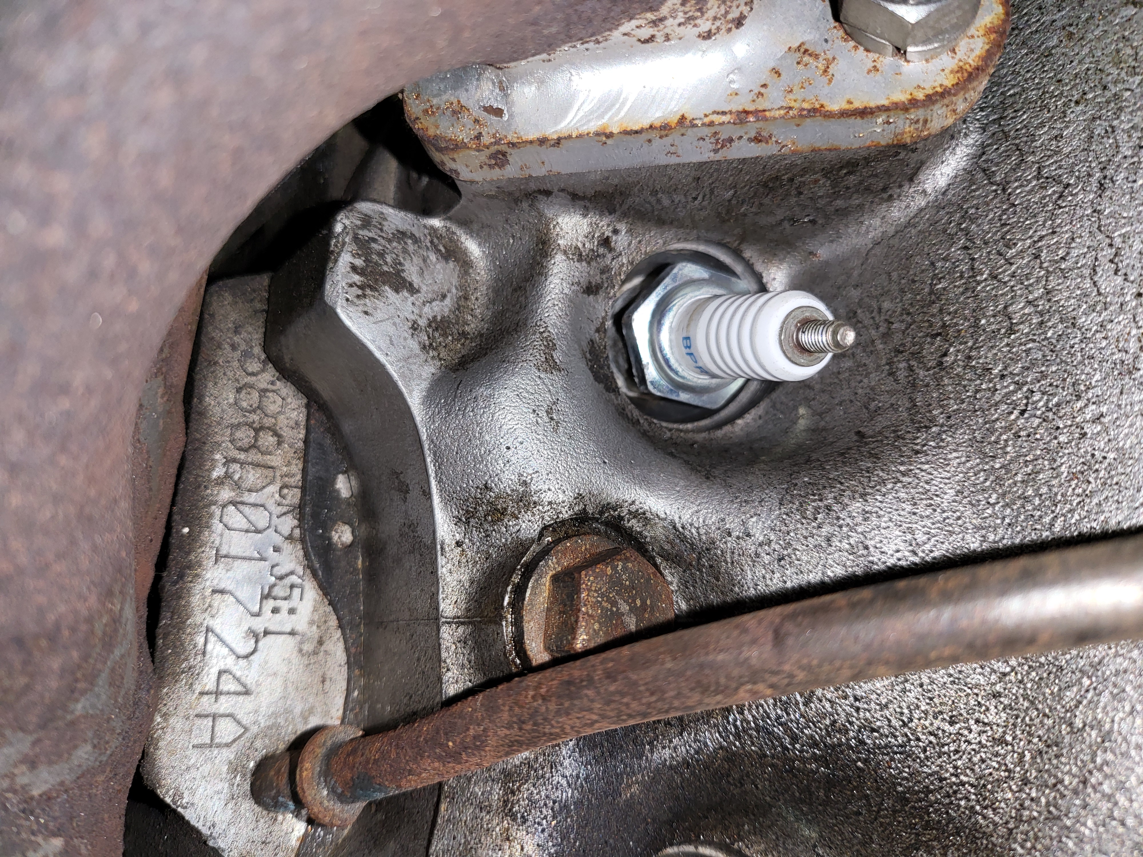

Hi all. Just signed up and in need of expert help! I have an ac cobra replica with what looks like Rover V8. I have spoken to British Motor Museum who cannot ID it! So here's the challenge...the engine number is... S88D01724A and the cast on the block is the usual LOF000250. Desperate of London. Steve.
Re: Rover V8 Engine Numbers Updated:
The S88 at the start is most odd - almost like it's been 'overwritten' by stamping 888 over the first few digits.
Or that the block has been decked and it restamped in error?
Does it look like the original Rover stamping?

Hi ChrisJC [/b]and thanks for coming back to me. The number is etched not stamped. I have been advised it is an original exchange engine engine destined for the US market but British Motor Museum have no exchange records. I'll try and get a pic of the stamp but it definitely looks like a Rover V8 (which size is another story - 3.5, 4.0 or 4.6!) The plot thickens....

I'll definitely go along with it being a factory number with that style of engraving. That's how the P38 engines were done.
Is it a cross-bolted block?

If you look around the bottom of the block, there is a bolt in the side of the block going through into the main bearing cap. So that's 5 down each side. They are not present on the pre Range Rover P38 engines. It at least gives a bit of a clue as to its age. Noting that actually, the different capacities were achieved by a different crankshaft, all of the bores are the same. So the 9.35:1 stamped on it has no bearing on the block, that was a function of the pistons! I believe all of the blocks were the same.

SteiveD wrote: Mon Oct 18, 2021 10:44 am 20211009_173034.jpg
Does the S prefix denote a factory engine that was for service rather than destined for a new built car. Maybe to replace an existing engine under warranty? The rest of the number would just be a sequential identification rather than a number matching a specific VIN on a brand new vehicle.

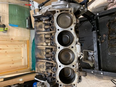

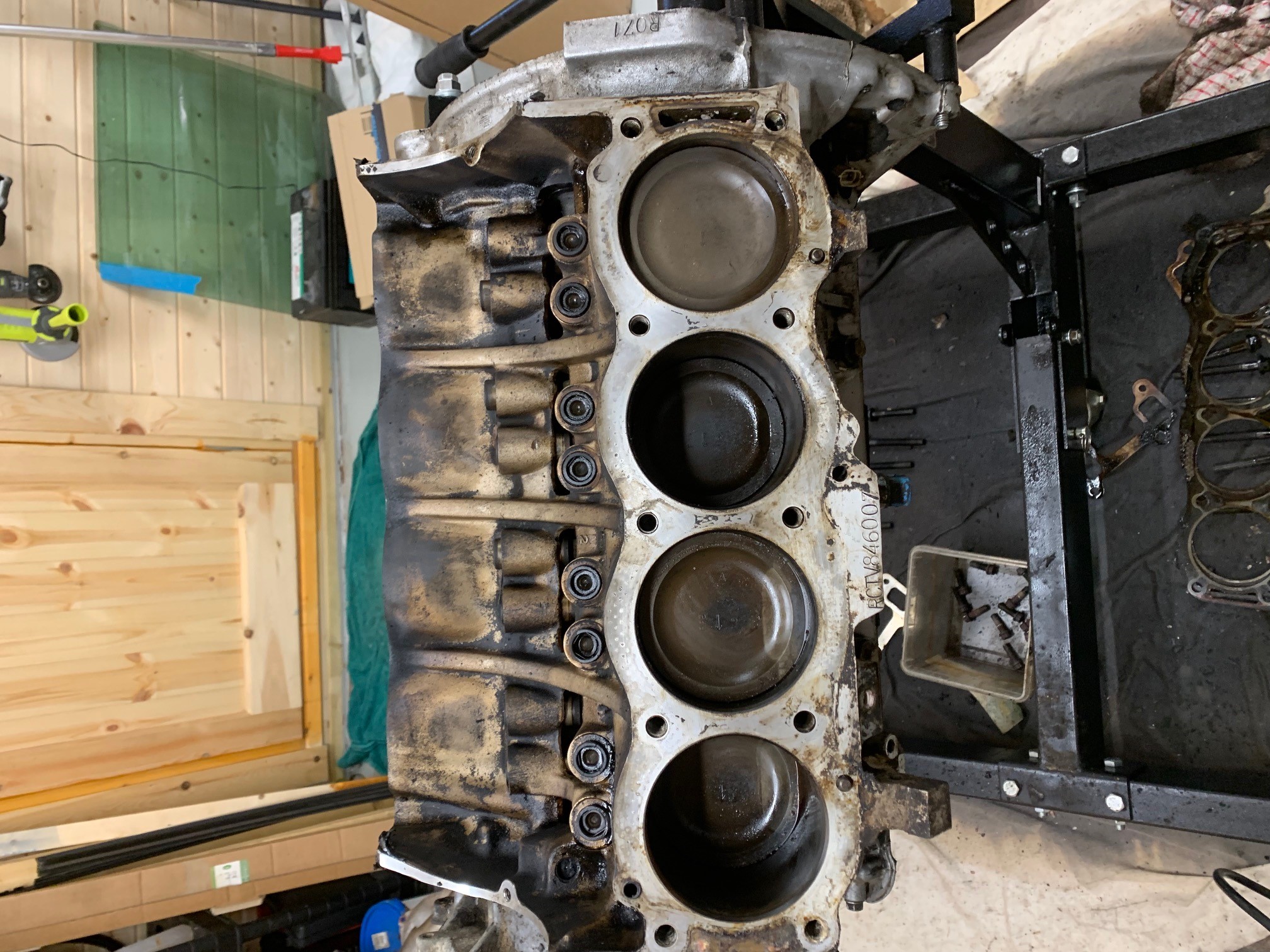

Good afternoon all,
I am having my Rover V8 4.6 rebuilt and would like to try to identify the engine number. The engine was out of a RR P38 1997 but the engine number is RCTV846007.
Does anyone know where and when this engine was produced or whether is was remanufactured? I have attached a photo if that helps.
Any light that can be shed on this would be greatly appreciated.
Many thanks.

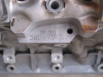

That is not the original stamping so probably not the original number. When the blocks were stamped when being made it would have been in a "dot matrix" style and have the compression ratio stamped as well - it looks as if the number you have has been manually stamped possibly after the top of the block being shaved.
If original it should look something like this

Thanks Garrycol for the info :D
Does anyone know who would have performed this work? I am thinking that having restamped the engine that it must have been an engine rebuilder or reconditioner somewhere...........
