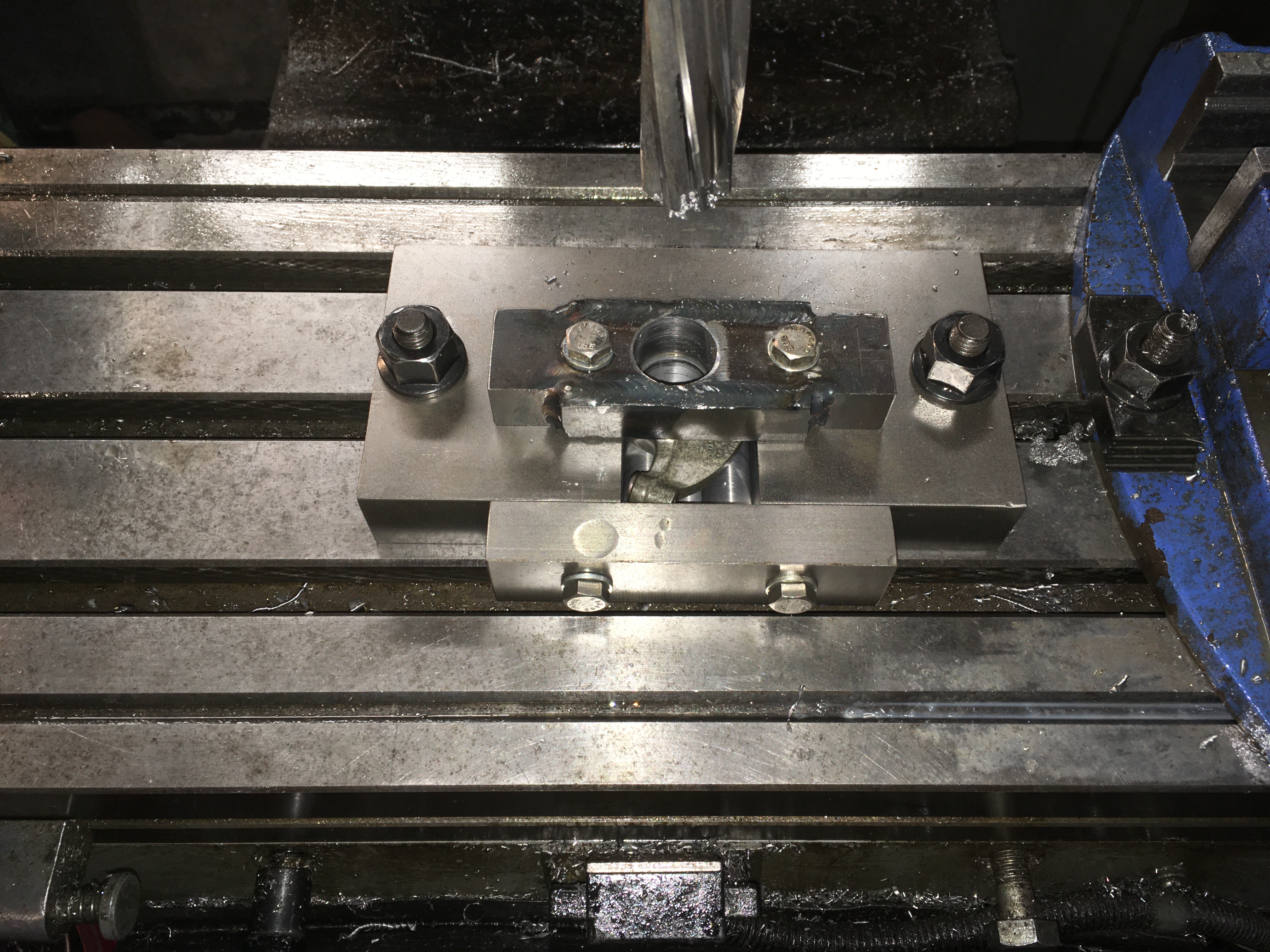

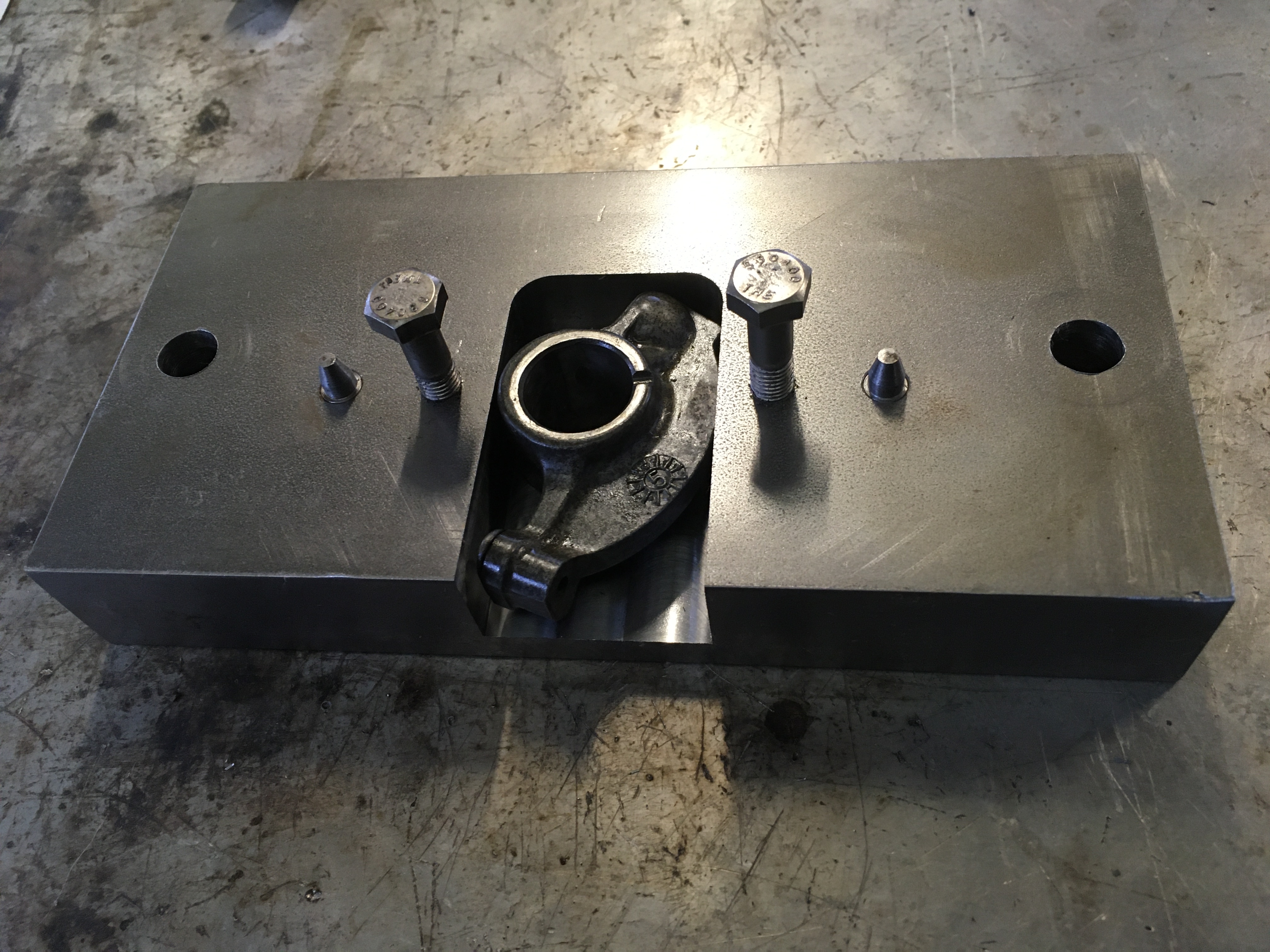

Next was to machine a mount into which the rockers can be placed securely so they can be first drilled to 22.5mm and then reamed to 22.98mm. I also machined a simple alignment tool so when the rocker is clamped the bed of the mill can be aligned with the spindle before machining the rocker. I utilised Land Rover flywheel dowel pins as locators to ensure I can repeatedly position the clamps accurately. Maybe overkill but it was fun.

Next job is to ream all the rockers. Currently half way through so pictures to come.
