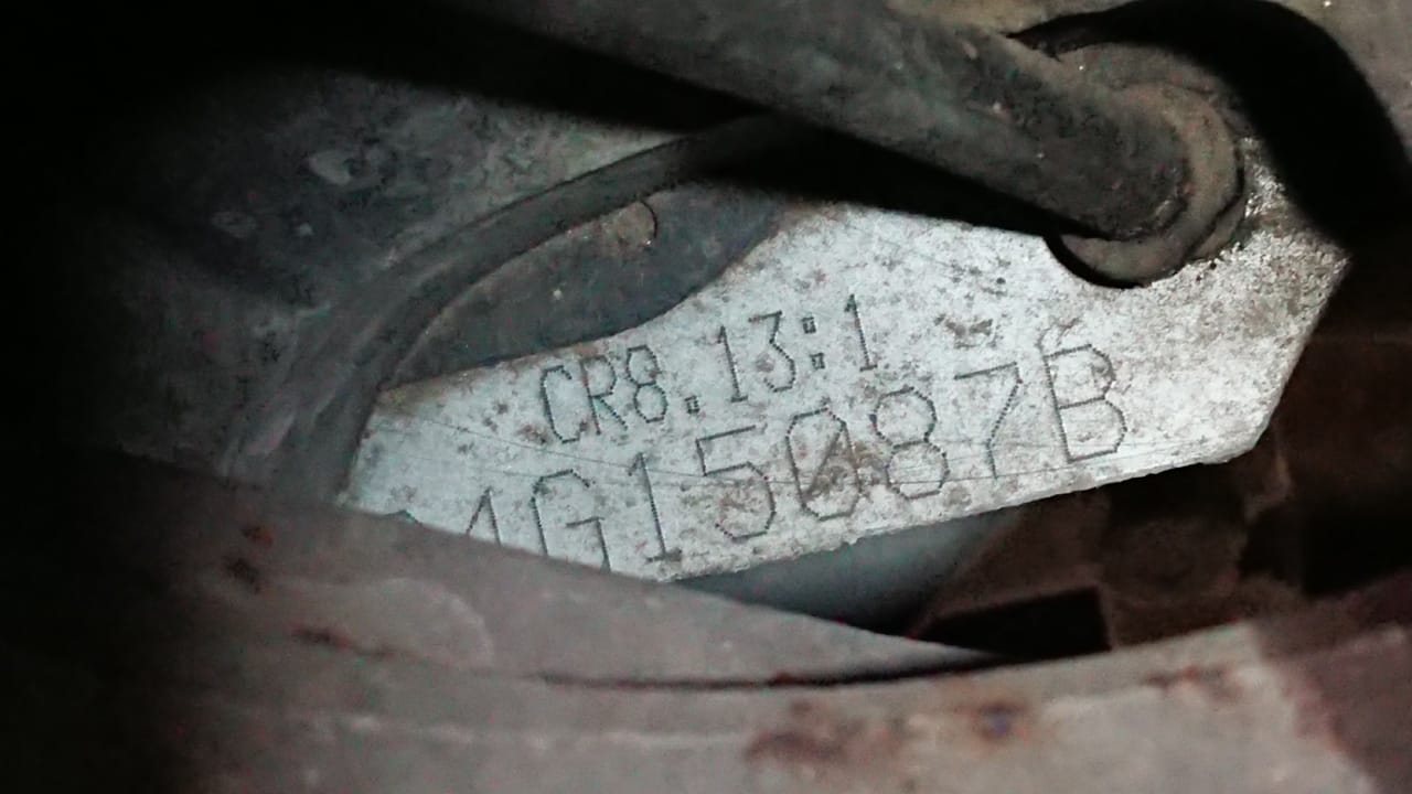

Hello guys.
I´m new here, but I really need your help.
I have a Defender 110 1994 but in bad shape, I will restore it. The previous owner loose the engine, I only know the serial number: 24G12510B
Please help me if one of you have a motor near to this serial, confirming if your serial is manually stamped or if is printed in small point.
A couple or friends has same engines (both are from 1994) sent me this:
24G12166B : manual stamp
24G15087B : machined with little dots
My engine is in the middle but is really important for me clarify the technique.
Thanks for your help.
More clear with pictures
