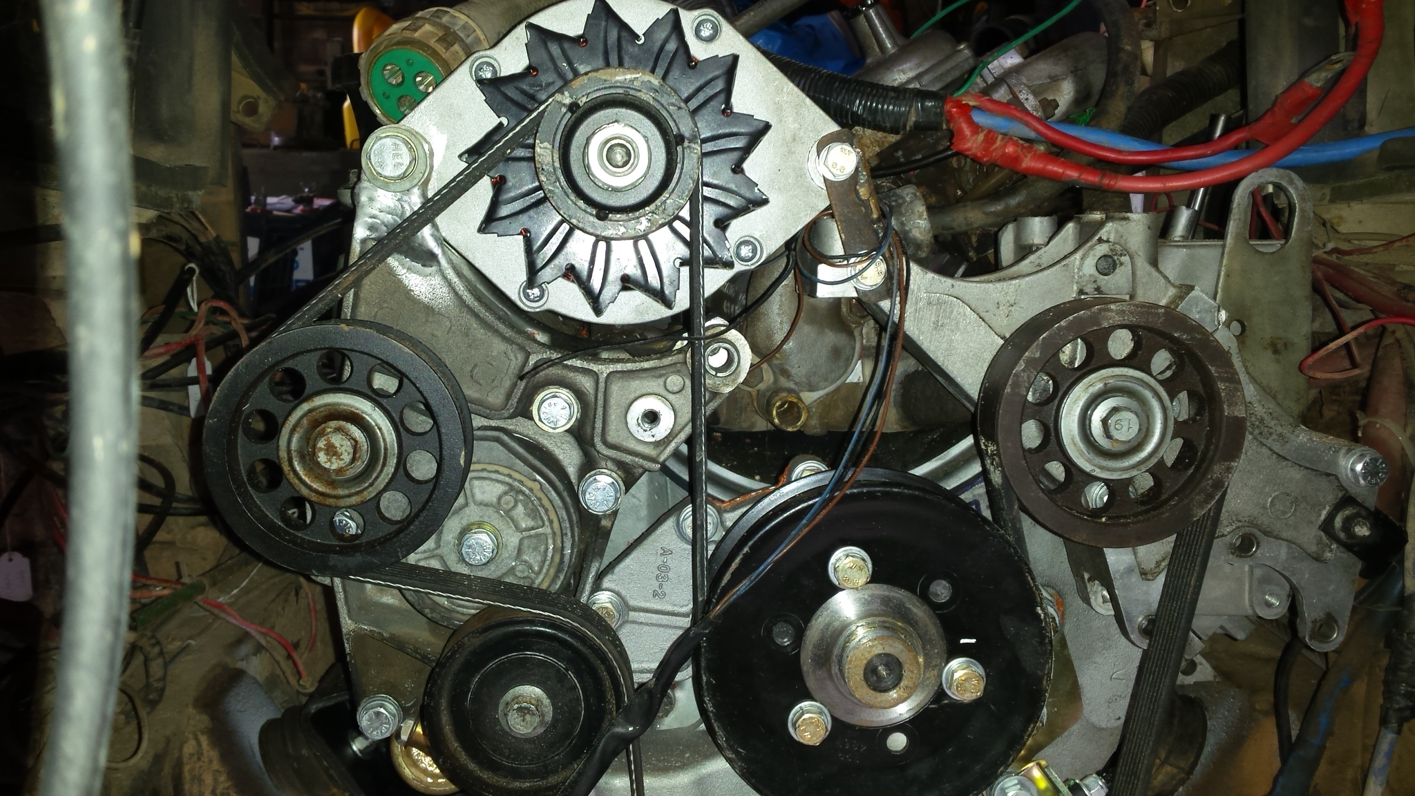

You are missing an idler pulley on the RHS - I had the same issue on my Fc 101 - there is not enough contact between the belt and water pump pulley - it needs to go around the bottom of the water pump and up to the idler and back down to the crank etc. See my pic below
Do not burnish the water pump pulley, it will make the belt fail quickly.
I have the extra stuff on the left side but yours should work with just the extra idler on the right hand side - can you not fit a standard tensioner without the idler I have on the LHS - when setting mine up I did have the option of no LH idler but as I had the room I put it in.
Garry

Yep, I had your set up and the belt slipped. So then I put a self-tensioner on the RHS (looking at your engine) and it made no difference. Then on this forum it was pointed out that the self-rensioner MUST be on the LHS as when you blip the throttle the pull simply slackens the belt. So I made up a strong bracket for an idler wheel (off the self-tensioner) that you can just see in this photo.
I ended up with a simple W shaped belt run. BTW it is easy to get belts any size you want if you did not know. Just find a local belt motor factor.
Next thing, I was still having cooling probllems (turned out a blocked rad) but still decided to have a two way rad. Very easy to do by putting in a baffle plate in the header tank and move the outlet from the bottom to the top. This makes an enormous difference as the water is forced down the RHS and up the LHS and gets cooled by virtually the whole of the rad instead of the water just going from top right to bottom left.
My car is pretty much the same as yours.
Richard.

+ I made my own adjustment mechanism using a long bolt pivoted between the alternator and water pump bolts just seen in the above photo. Again easy to do and like your solution.
Richard.

As suggested in several other posts about your overheating problem - this explains you overheating problem. Insufficient belt wrap arround the water pump pulley.
In this case you just need an idler pulley on the right hand side of your engine so the belt can wrap at least 180 degs arround the water pump pulley.

SuperV8 wrote: Mon Sep 07, 2020 12:23 pm In this case you just need an idler pulley on the right hand side of your engine so the belt can wrap at least 180 degs arround the water pump pulley.
As per my pic :D
