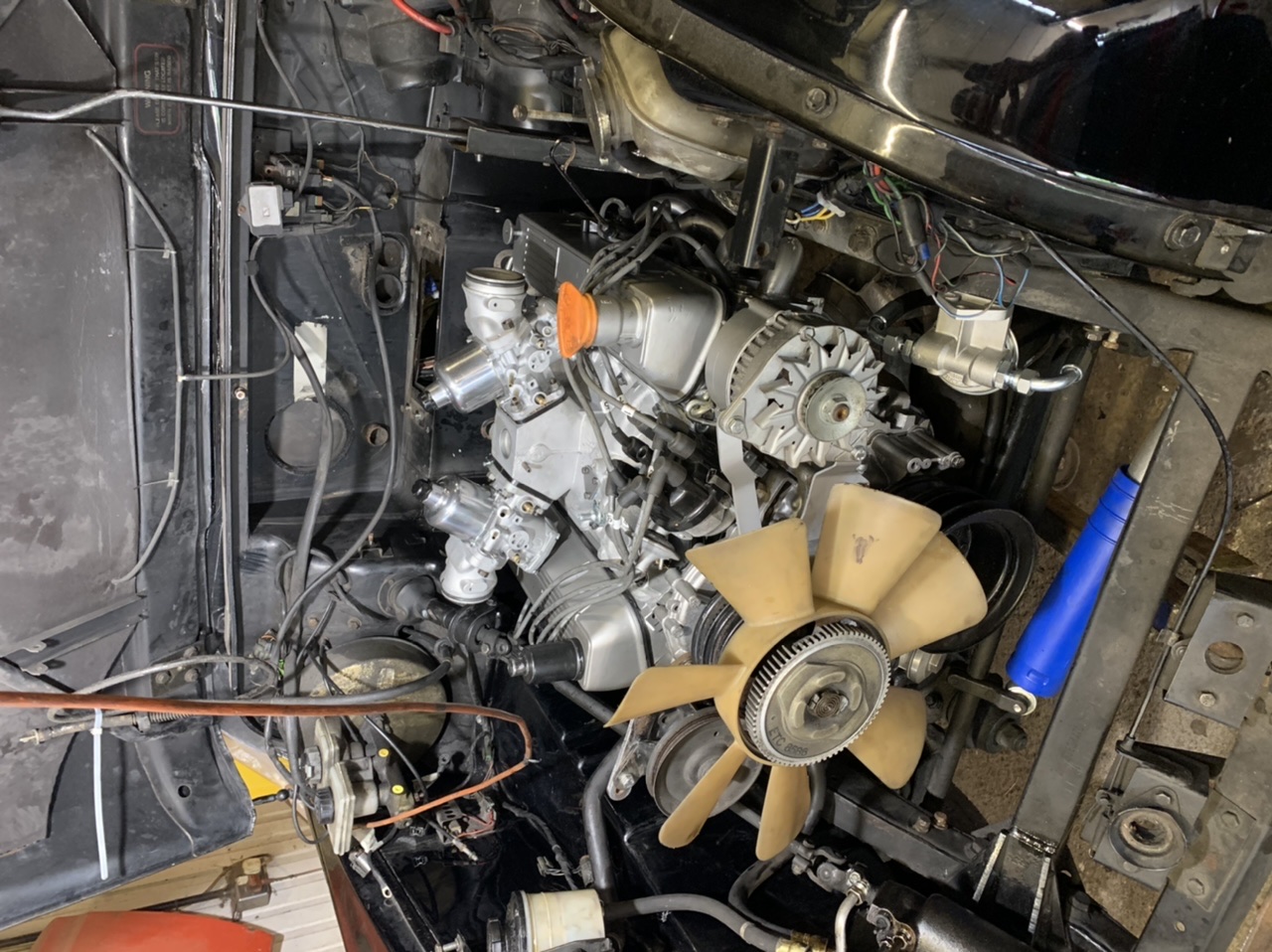

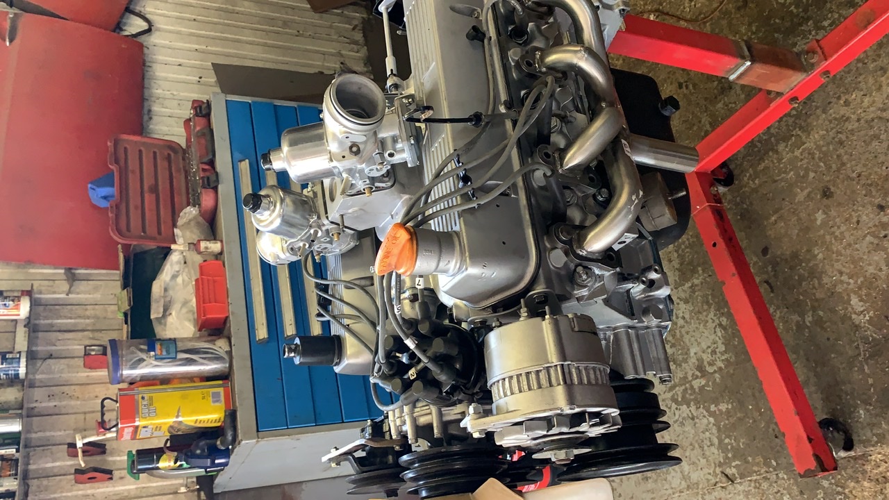

Here’s where we are at the moment. The EFI has been taken off and replaced with SU carburettors.
The heel boxes have been pocketed slightly to allow access to the spark plugs and the bonnet stay moved slightly for the same reason.
The ancillaries have been put on including the original Nissan PAS pump.
A new radiator based on that used by the MGB V8 is being fitted along with a remote oil filter onto the left chassis leg.
The heater is away getting blasted and repainted.
A box to convert electric speed signals to a rotary signal has arrived and that will go on the shelf where the diesel filter used to be. The taxi meter and door lock transducer will be put on this box too so those systems still work.
I’ll keep you updated if you guys are interested...

Yep, interested. Not seen one of these done before!
