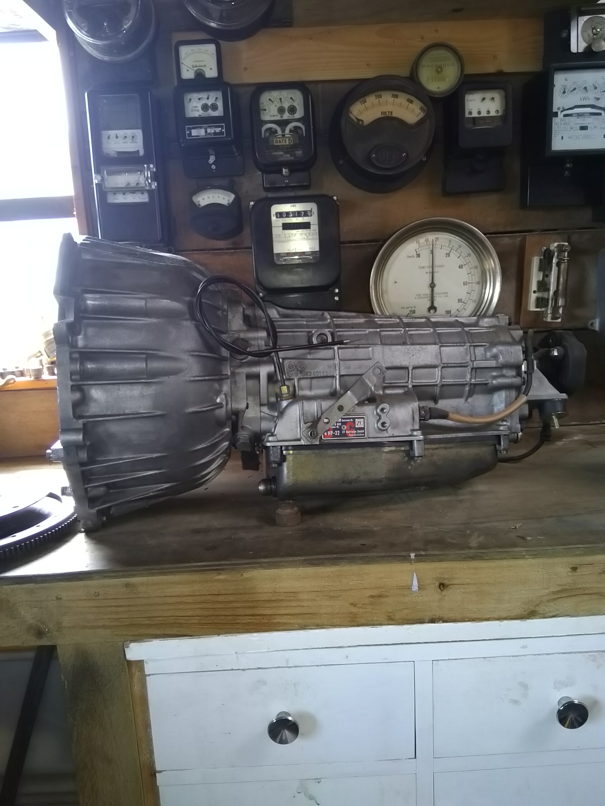

I have fitted a 4hp22 to my rv8. I got a full hydraulic box from a bmw , a rangerover bell housing and torque conv ect ( bolts straight on and spigot fits rv8 crank). Its no longer than the 5 speed toyota box and bell housing . Happy to post pix and measurements if you want .

Ok , a few dimentions 4hp22
Spigot nose to bellhousing face. 50mm
Bell housing length 200mm
Trans length 540mm

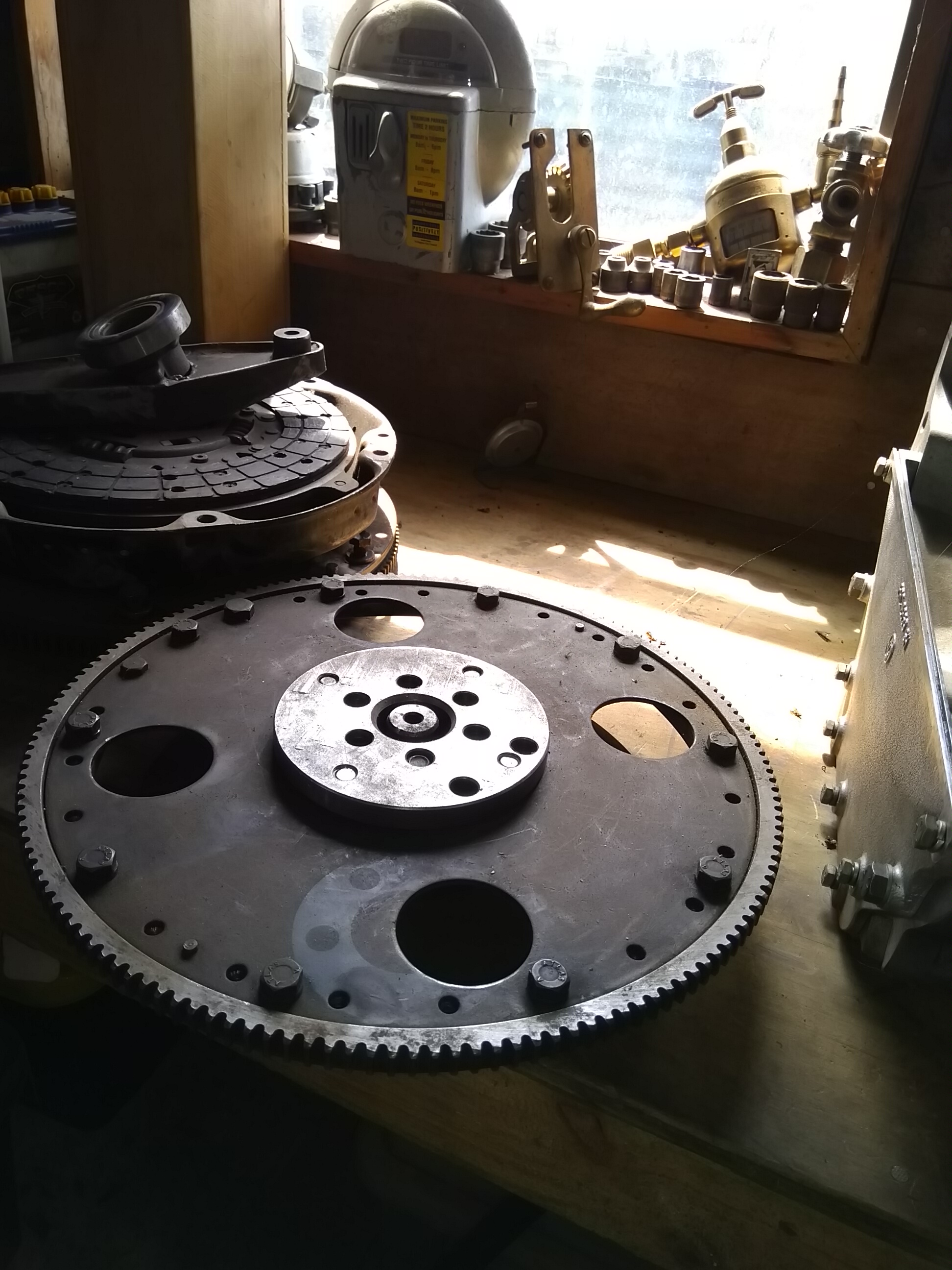

Ring gear assy length as pictured 65mm
Oal 740mm
Toyo
Bellhousing 160mm
Oal 740mm
Mc Tool
Posts: 123
Re: Difference
Post by Mc Tool »
The oal measurement is from the bellhousing front face to the end of the rubber drive coupling onthe 4hp , and from bellhousing face to the end of the black shield that surrounds the universal joint.
This trans came from a bmw and is the same as the 4wd except the transfer box. The bell housing off a rr tilts the trans 10 deg to the right , in the pic the bellhousing is level and the socket under the pan is 40mm high. My plan was to cut the front ,side and back of the pan and bend it down till level and then weld in a wedge shaped bit of panel steel. The rr has a deeper sump and pick up than the 2wd . A smarter move would be to get a trans from a Jag ( they put these trans's in heaps of cars ) as it has a speedo drive ( bmw one is on the diff ). This trans is full hydraulic with a switched wire for the converter lock up. I removed the bmw bell housing , fitted the rr one ( must remove front cover of trans to do this) and fitted the rr converter to the trans (straight fit ) . The spacers in the ring gear assy looks to add about an inch to the overall length. With the correct bell housing my 5 speed toyota box could be changed out for a 5 speed 4wd toyota box. Have a google of toyota w series 5 speeds as some are stronger than others and there are some variation in ratios
Hope this helps :)
