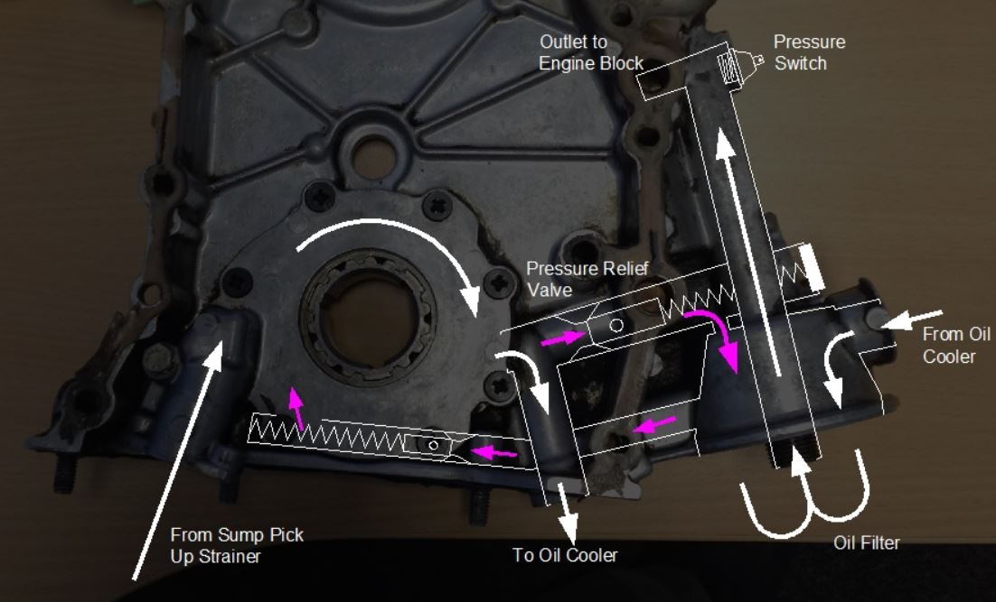

I think think this is my strategy now, and that's to get it back together and fire it up for 30 seconds. I've done some further digging and found this nicely drawn diagram of the front cover. A few things spring to mind. It makes sense that cranking does not see oil pressure on a new engine, as it seems the pressure relief valve acts more like a pressure regulator valve. Clearly this needs to have enough initial pressure to move, and that may explain why the cranking revs (around 300rpm) is not enough. If this doesn't open, then no oil pressure....unless you have an oil cooler (which I dont). Also, a good check maybe removing the oil cooler bung...in theory that by passes the valve and oil should pour out even on crank.
