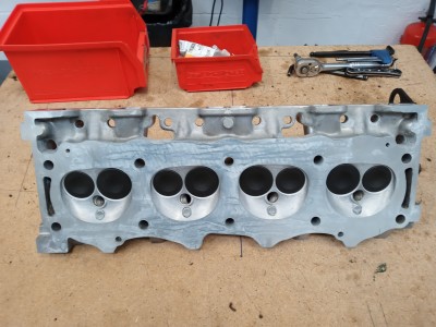

Next up I turned to the bowl behind the valve. Obviously the valve guide protrudes in to the port and was going to get in the way so rather than get the guides knocked out, I instead drilled them out. I used a 10mm and then a 12mm drill to open the guide out, drilling down so the hole went slightly deeper than the level of the head. They actually drilled out easier than I expected and I used some CT90 cutting fluid that I got from Toolstation which seemed to help.
Once the guides are drilled out 12mm, it leaves around 1.5mm of wall which meant I could break off the remaining guide using a 6" socket extension down the port and a few swift taps with a hammer. Some of the guides remained above the port surface, but this was easily ground flush with a burr.
Here is one of the exhaust ports before and after. One thing I did notice is that unlike some of the heads I've seen in other posts on the forum, there's no noticeable step between the cast aluminium of the bowl and the inside diameter of the valve seat which I presume is the normal condition on the later heads.
The inlet bowls were similarly cleaned and blended. The finish here is pretty much as achieved with the burrs, I still need to get the emery out for a final smooth off.
Now for a question. I'm using bigger valves 1.5mm bigger inlet and 1.2mm bigger exhaust which also have the benefit of a better shape on the back of the valve head.
The valve seats will need to be re-cut for the larger valve but the throat of the insert is still the same size and probably the smaller part of the whole port. On the inlets this is around 34.7mm and on the exhaust it's 28.3mm. Is there any reason why I shouldn't get the throat of the insert opened out to get a bit more flow otherwise the increase in valve size seems a bit pointless. I'm pretty sure I can get this done at the same time as the valve seats and then blend the bowl back in to the seat. If I was going to fit the biggest possible valves with new seats I'd be doing this, so why not do it now?

If you are using 41.5mm inlet. Throat should be +37mm. But std valve seat will limit it to approx +36mm.
If you are replacing seats. Dont go over 43mm inlet valve, because bigger wont help. It will resist flow to mutch. New seat is way to go if you want more power. Maybe some 42-42.5mm valve and new seat and throat approx 38.5mm is way to go. 43mm valve wont help anymore because port will resist to mutch.
Smaller valve you will get better short side radius and you can grind and smooth rest of. But it will take lot of time.

Thanks for the reply.
I'm definitely sticking with the standard seats so I'm not planning on going much bigger in diameter on the throats. 36mm would be 1.3mm bigger (slightly less than the increase in the inlet valve size).
Exhausts I'm thinking increase from 28.3 to maybe 29.5mm?
This is more an exercise on seeing what improvements can be make from some head work rather than chasing big numbers. Currently I'm running 246bhp / 380Nm

Using the Real-Steel larger 41.5mm inlet valve I managed to increase the valve seat insert by 4mm+ just be careful when pushing things I used engineers dye to keep things in check and not break into the increased valve sizes seats future area

I managed to get my heads dropped off for machining on Wednesday. The guy there said that the valve guides are difficult to remove by heating the head as this tends to cause the valve seats to fall out. To avoid this, he will machine the guides out to leave a very thin wall before drifting them out.
I am having the inlet valve throats opened out to 36mm and the exhausts to 30mm. I could maybe go a bit bigger but this will remove the majority of the material and be a safe starting point.

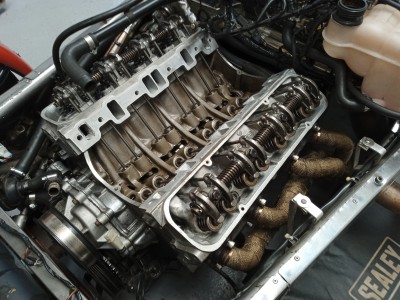

A somewhat overdue update here. I actually got the heads back from machining in October but due to other distractions, they were sat on a shelf for months before I got around to assembling them. No real issues putting everything together and here's an assembled head, looks just like a standard one. They have been skimmed but the hot tank left some water marks on the surface but it won't cause any problems.
I fitted the heads last week and while I had the engine it bits, I also fitted ARP head studs and steel rocker arms for added peace of mind.
I also fitted a new thermostat, just standard P38 because it's a fiddle to get to with the heads on and seemed like a good idea. Engine fired up fine and it does seem a bit more lively than before. My Emerald ECU is doing it's stuff with adaptive mapping but I need to get it on the rollers and set up properly to see what the actual numbers are compared to before.
