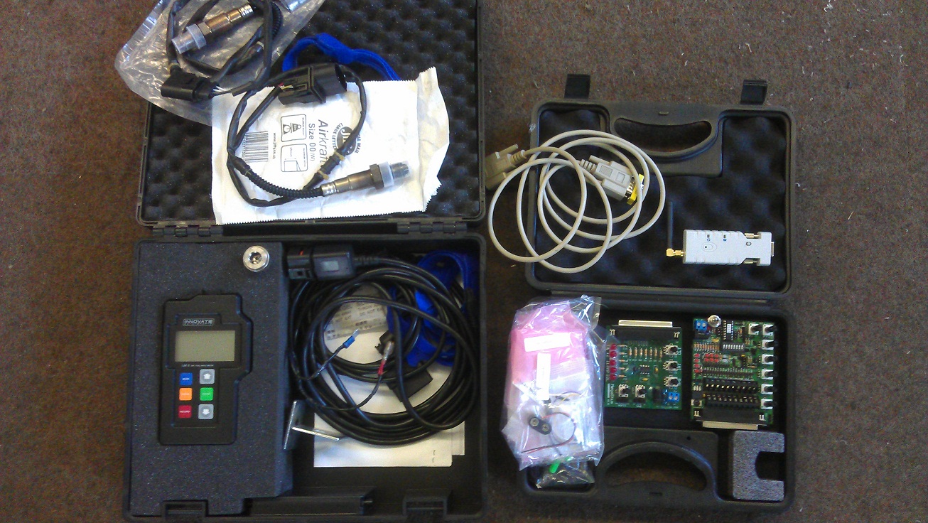

I had severals years of trouble with two Innovate LM-1 units. Lots of "dead" sensors and typical explanations (sensor location, grounding etc). One of the units was sent back to USA for warranty repairs and came back (naturally) with "no problems whatsoever". I tested heat sinks,various locations but to no avail. Finally bought an AEM wide band and have not had issue ever since. Same sensor, same location. Maybe Innovate makes too sensitive equipment for automotive use

Well it looks like I have done my $$$$ - sensor installed but not yet connected electrically. I guess I will use until it fails and get something else.
