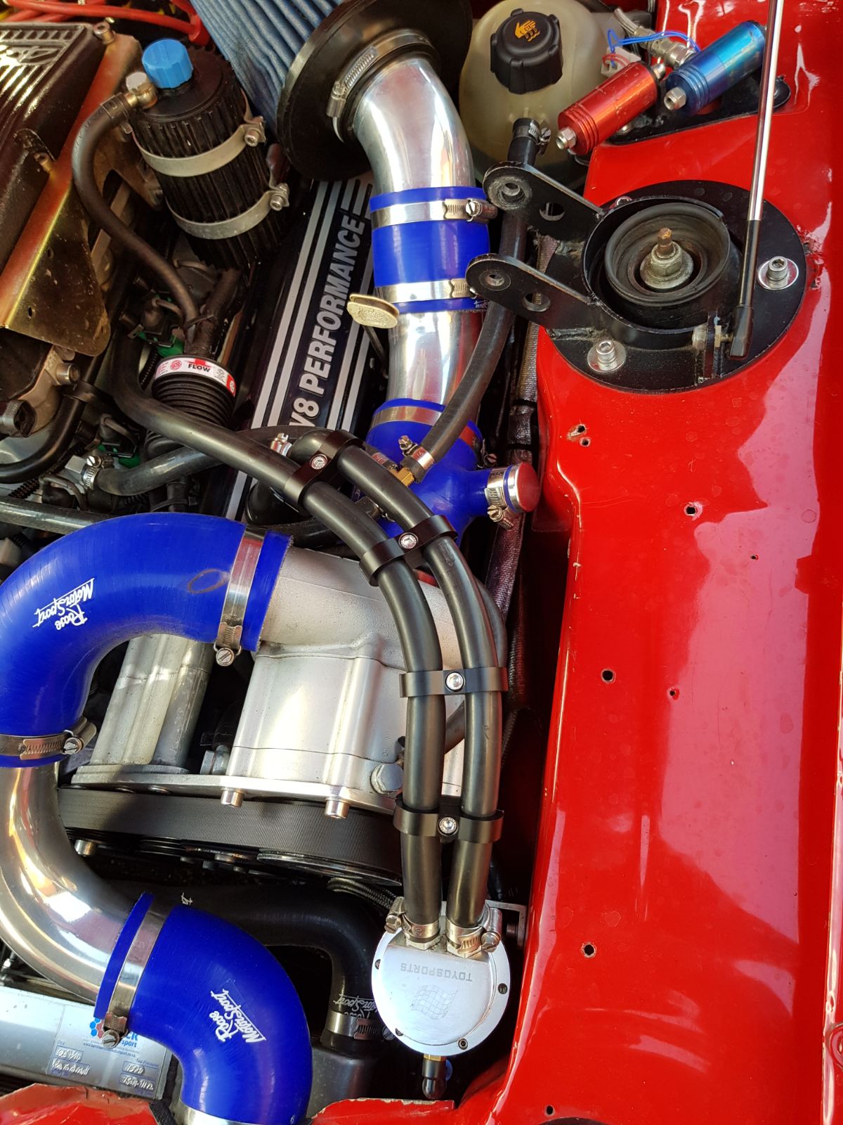

lifted the bonnet oil smoke from passengers side and around the breather catch can like last time,
limped the car home was getting ready to call Rossco to tell him i've killed it, but first decided to clean engine off, and to my relief. the breather hose from the catch can to the vent filter was split which was the smell, and the flame trap on the passengers side rocker cover was loose and allowing oil to run along the rocker cover and drip onto the exhaust manifold also the smell but also the smoke,
just had a road test and all is fine THANKGOD!!!
