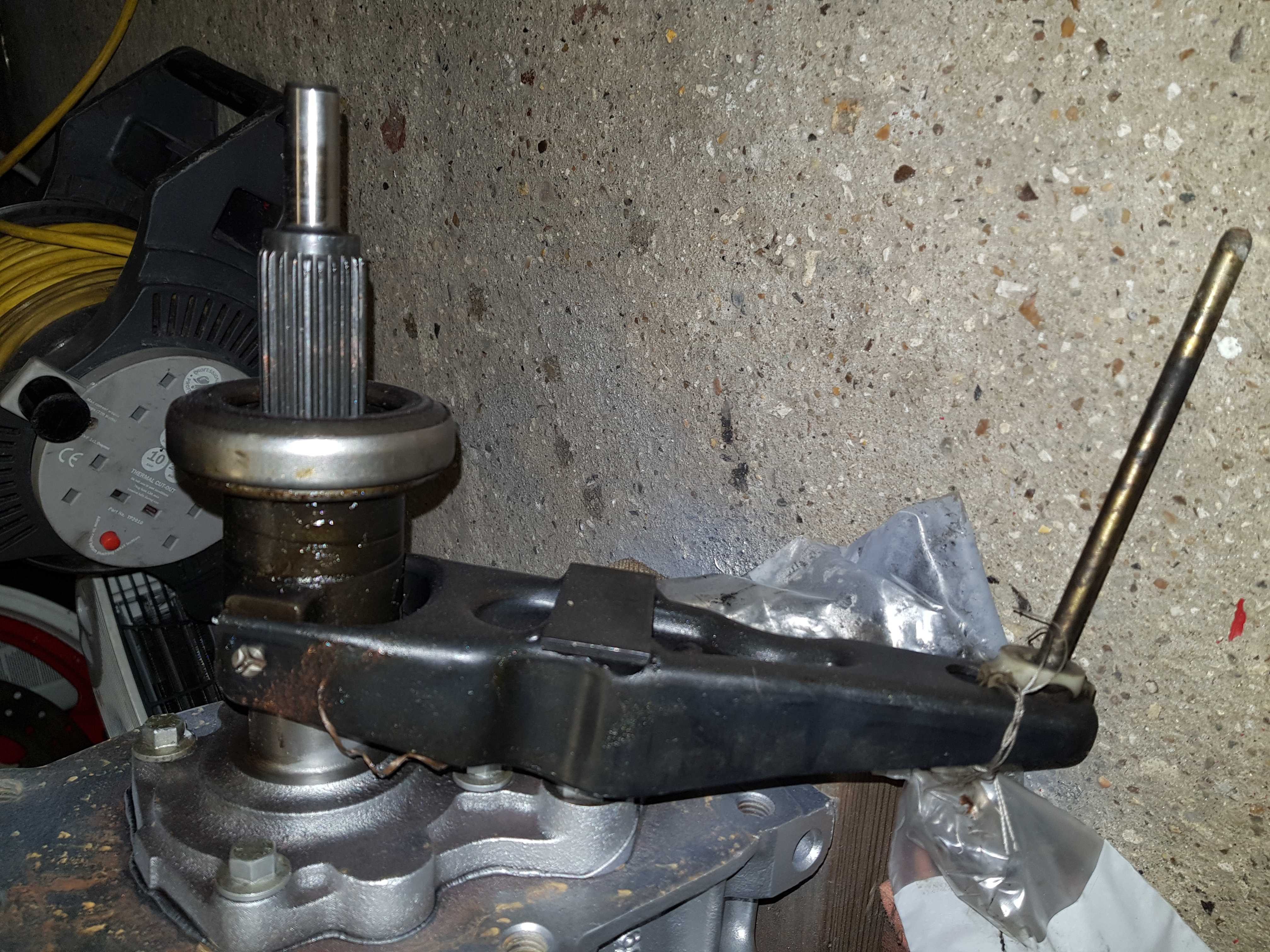

GDCorba this is it with slave removed so with slave fitted it's pretty much right angle to the gearbox input shaft
Thanks Sam

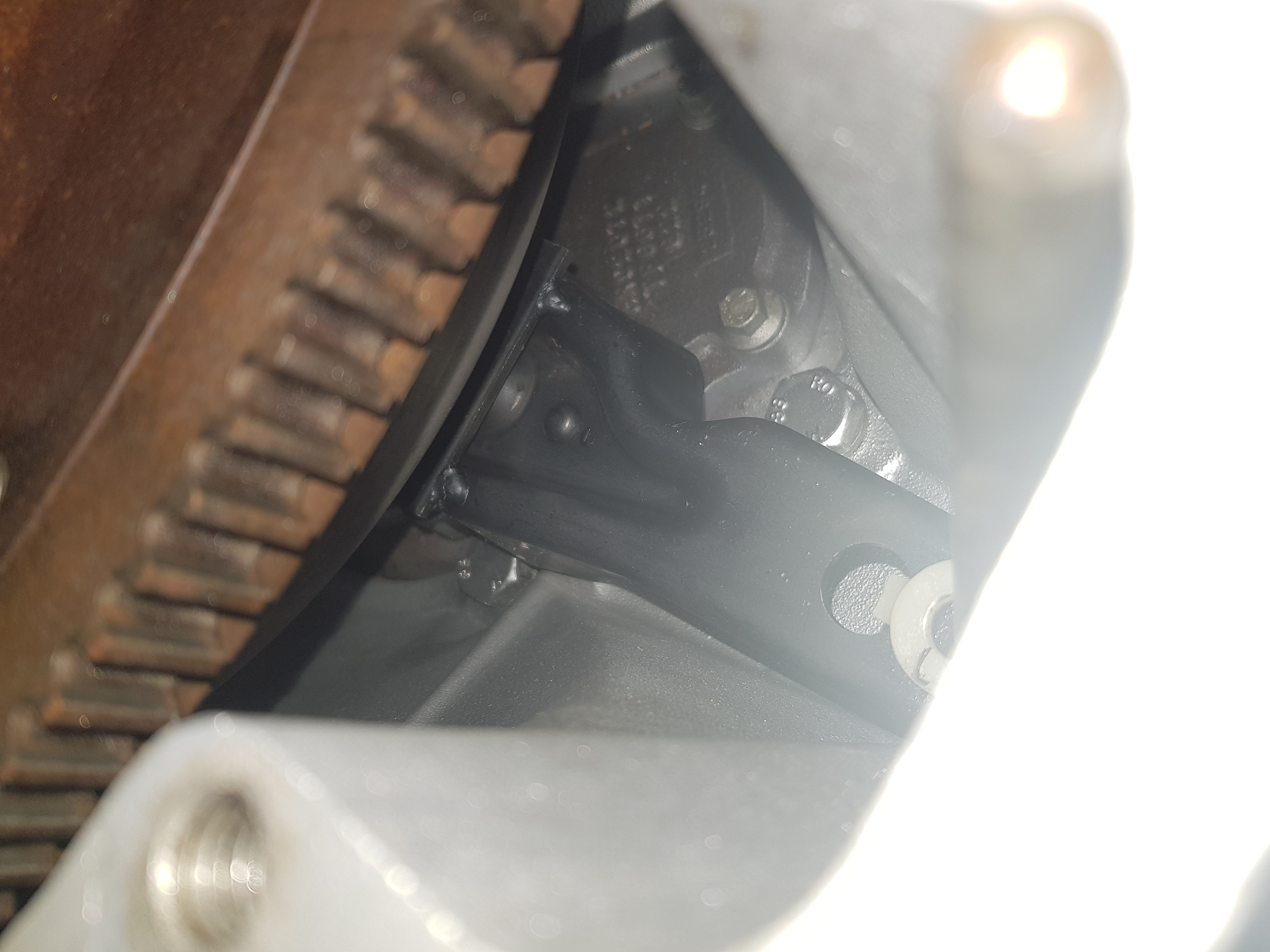

You can just see where it's catching on the casting to the middle left side of the fork. Bolts are further back than they look

Photos can be deceiving but I would say that the fork needs to be at the angle shown in the photo when the bearing is just in contact with the clutch, ie move the lot forwards with a taller pivot
