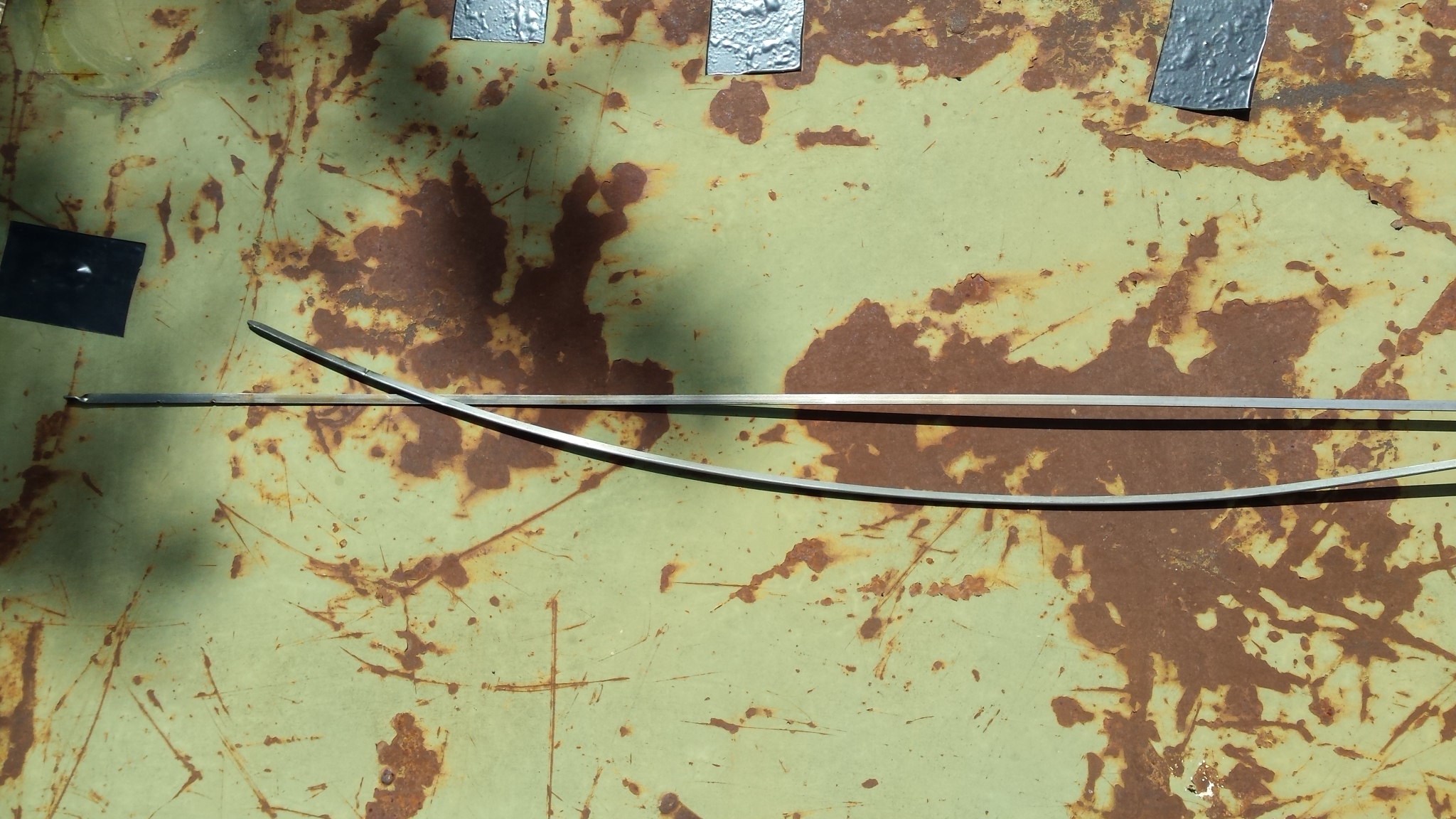

Here is a pic of the two dip sticks side by side with the tops (out of frame) aligned - the longer one is the 4.6 and the shorter one is the 3.9. As mentioned this assumes the 4.6 has the correct alloy sump and correct length dipstick tube and the 3.9 has the correct tin sump and correct length dipstick tube - these are from a Disco 1 and Disco 2 - obviously engines from different makes such as TVRs etc or engines that have had parts mixed then that confuses matters.
The length of the tube on my 3.9 is 11.5" and the 4.6 is about 13" (hard to measure with the engine in the vehicle) so if using a standard sump with standard tube you are probably over filling your sump but there are many variables. if you have a standard alloy sump and the correct tube just get the correct dip stick from a wrecker.

garrycol wrote: Tue Mar 06, 2018 4:15 am If you have the correct cast alloy sump on your 4.6 I would be using the 3.9 dip stick as it is shorter - assuming the dipstick is from a 3.9 with the tin sump.
Capacity from dry is 6.6 litres but refill is 5.8 litres.
Garry
The dipstick and tube have to be matched, if you use the long stick and short tube the oil level will be very low.
I put some measurements earlier from the sump face to the stick for my 3.9, maybe these need to increase for the longer crank throw or maybe not but difference is not going to be a couple of inches.

From the previous pics my dipstick is from a 3.9 (my previous engine) and as I am using the same sump in this 4.6 should be ok. I know that my engine with oil cooler holds approx 6 ltrs of oil at the full make so am not worried about not having enough. My main concern was that I had heard that if over full the crank could dip into the oil and cause all sorts of issues; however, by placing the dip stick on the outside of the engine (as an approximation) I can see that the full mark is about 1" below the top of the lower scavenge area of sump pan therefore would be well clear of the crank.
So I now feel reasonably happy that I can use this 3.9 dipstick and sump pan for my 4.6
My thanks to everyone for taking the time to comment which has steered me in the right direction.
