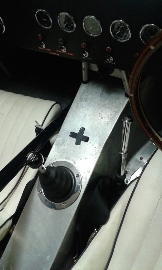

Here`s my proposed mod.
As you can see from this photo, reducing the remote by 61/2" puts the lever at 'X', which is still 2 or 3" short of the location of an original Cobra`s gearlever, but is a significant improvement in useability!
Fortunately, I have a spare gearbox I can do mock-up tests on, and roughly eyeballing it suggests I might not have room for the coverplate under the lever, possibly the reverse baulk plate might be an issue too!
