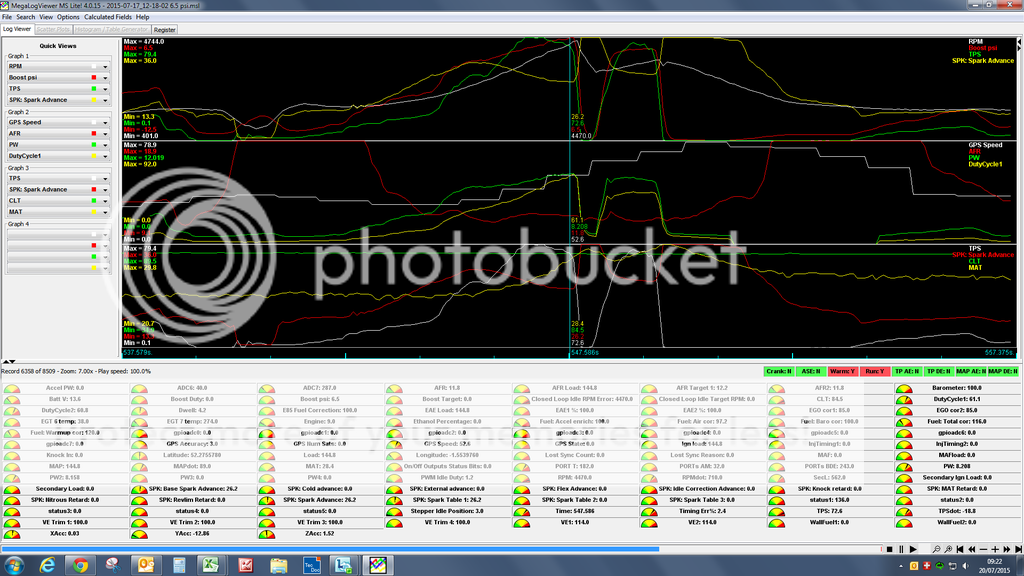

Very rich - 9:1 AFR at 6.5psi and 4470rpm, 61% duty cycle and spark at 26degs.
My AFT target was 12.2 at that boost and RPM - does this seem reasonable?
How about the timing - very conservative / ok / or too much?
Any thoughts welcome.
For those who haven't got tuner studio here's a screen print of the max boost I logged:
Any comments or recommendations?
