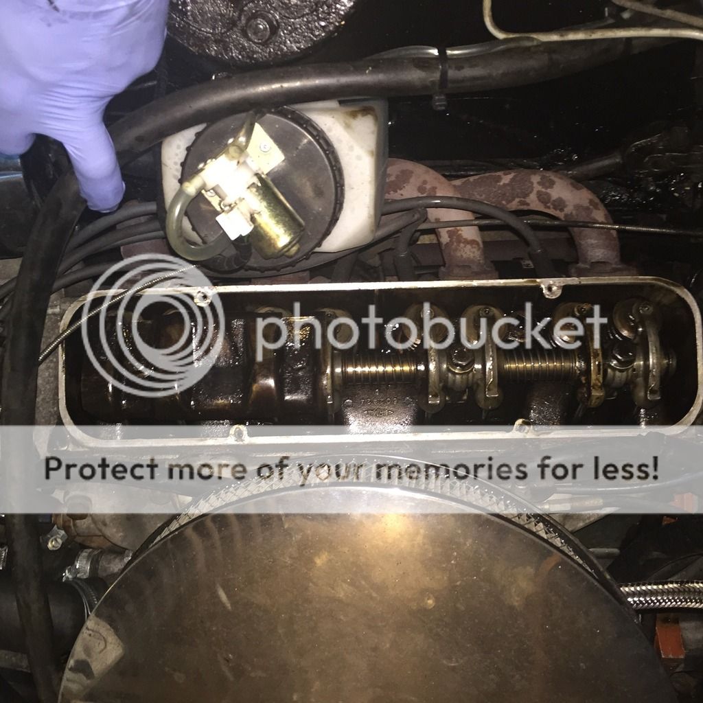

I'm in the process of refurbing my Triumph Stag's RV8. The block itself in an early P6 block, but the cylinder heads have SD1 rocker covers and 19mm spark plugs fitted. I think that my cylinder heads are the original Rover P6 ones, which means it actually needs much shorter plugs fitted. I've checked for the casting numbers mentioned in the sticky thread in this forum but can't see any of them (just a serial number between two of the rockers). Can anyone confirm which heads these are and which sparks they should use? Many thanks!

I've seen the Birmal casting mark on both early and later (slightly) bigger valve heads but from the looks of those valve caps you've got a set of early small valve P6 heads there.
To double check, measure the valve spring diameter, if they're 1.3" you've got early small valve heads, if 1.225-1.25" they're the later heads.
The early small valve P6 heads aren't great for power so it'd be worth swapping them out for some later heads.
P5B & P6B heads use double valve springs, SD1 onwards have singles.

I just check the exhaust port, if there is a radiused bump in the top left corner it's an early head. Easily visible and conclusive.

To save all the faffing around with head numbers why dont you just remove a spark plug and measure the spark plug thread depth in the heads ? You only need a bit of wire with the end bent to 90 degree's so you can hook it over the end of the plug hole and make a mark at the top of the thread on your wire. To be honest the difference between the long and short plug threads is ovbious when you shine torch down the hole?

Perry; I've already taken the liberty of doing this and I estimate the internal thread to be circa 13mm, this was the thing that originally prompted me to question why I had 19mm plugs. I haven't had a chance to measure the valve-spring yet, but I'm thinking I might just fit the new shorter plugs I've bought as see if they make a difference. I assume it will be very lumpy/won't start if it doesn't like them.
