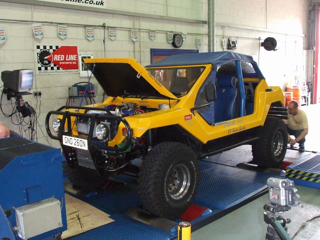

I've run the dakar on a dyno twice now - i run 35" general grabber mud terains.
picture:
http://www.mez.co.uk/dcam/DSCF3079.JPG

Awesome! Where was that? My peviously local rolling road in northants said they wanted me on road tyres. I am now in Birmingham - any body know a good 4 wheel RR here that knows mega jolt and carbs? Did you see a lot of transmission loss with those tyres?

Dyno was Marlin Motors in Bletchley. Perry organises dyno days there from time to time.
