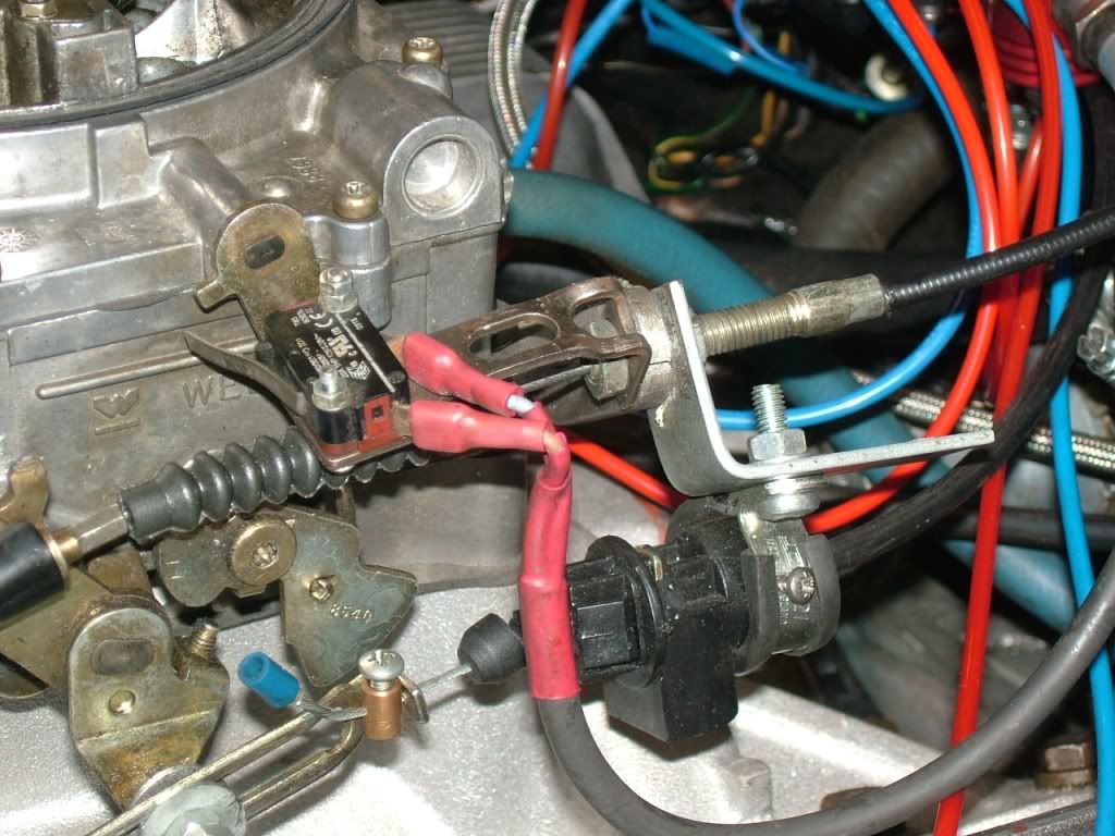

This may or may not help. I have a chevy gearbox. But it still has a kickdown cable that i fitted to the Weber 500 by making a small clamp
