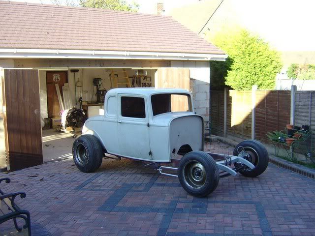

In my back yard, part asembled:

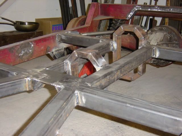

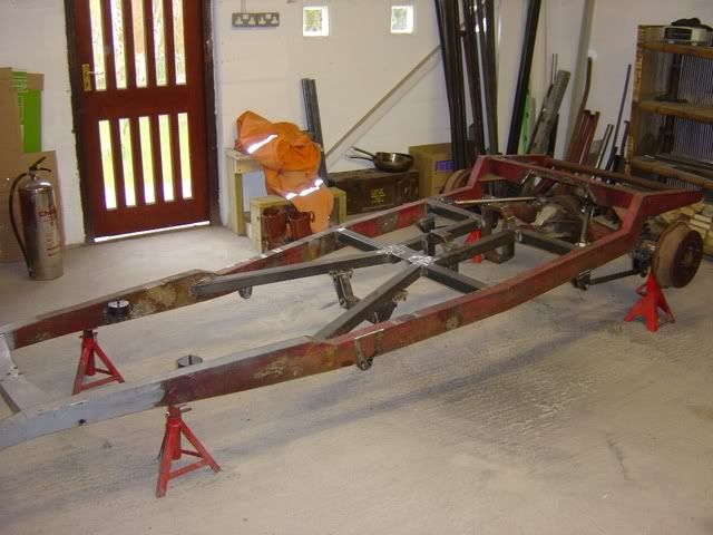

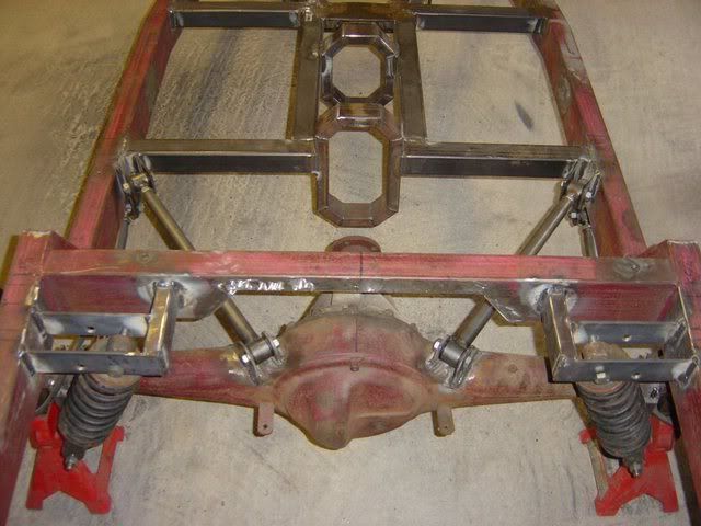

A bunch of chassis mods, triangulated four bar fitted, new crossmembers etc:

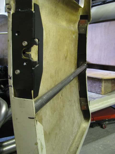

I'll admit, the steel work is pretty heavy duty, but I have this to drop onto the motor at some stage in the future:

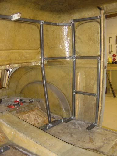

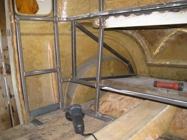

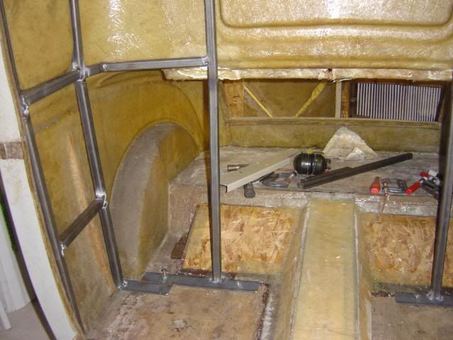

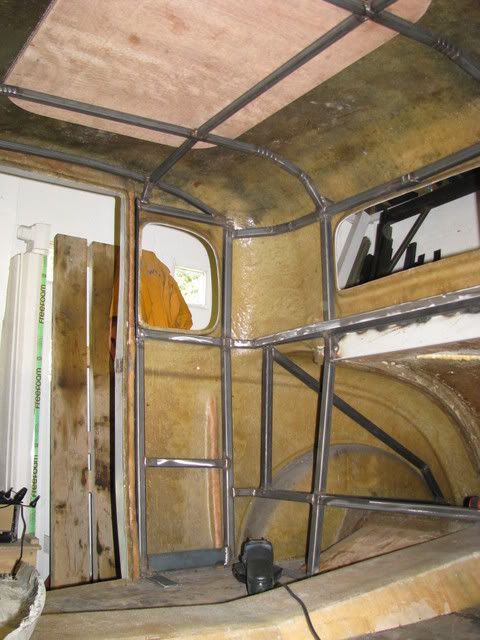

Here's the tubular steel stiffening going into the bodyshell, sort of a roll cage to make it a bit more sturdy:

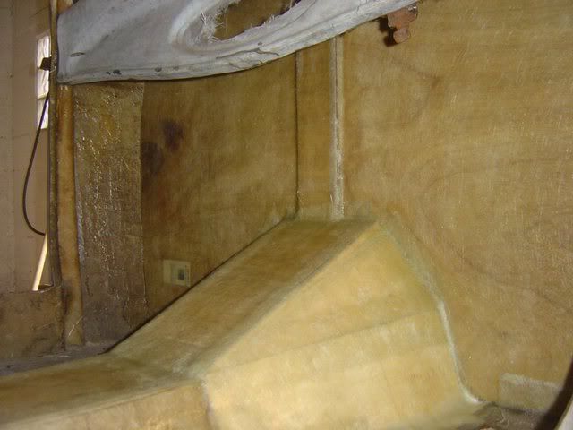

Firewall is 3/8" ply glassed over on both sides, and set back about 5" from stock:

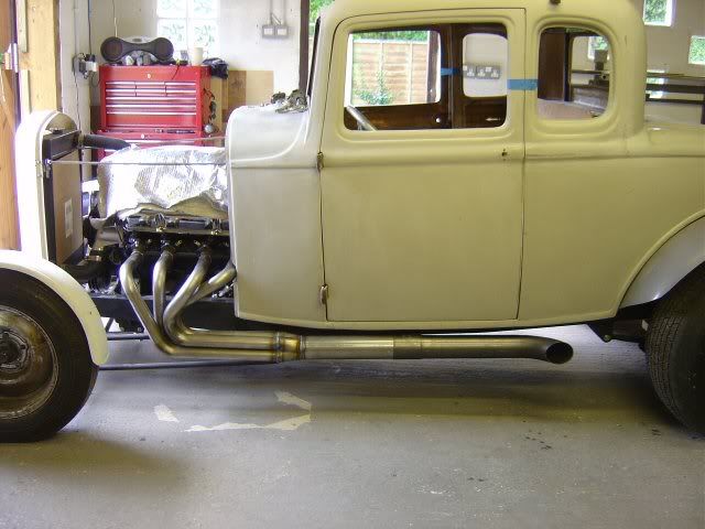

One day, hopefully, it'll look a bit like this:

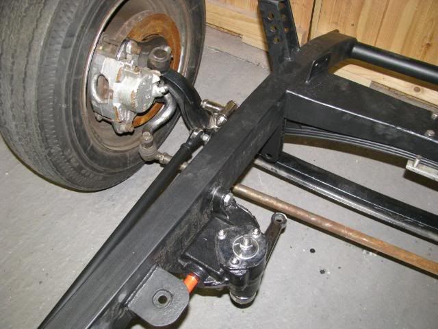

Paul B wrote: Image

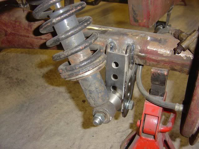

Not that I know anything about chassis building, but given that the coilovers are taking all the loading - isn't there a possibility of it bending that bolt?

I've seen so many cars with huge great cross members, and some with none at all, that I decided to go halfway but still keep everything nice and stiff and aligned. Hope it works....

Eliot wrote:
Paul B wrote: Image
The theory is that it is under tension rather than bending, as there is a compression tube inside the shocker rubber. It is meant to take 5/8" bolts, but someone has sleeved the shock to 1/2".
When I order the correct shocks (these are old Jag, I think) I'll use 5/8" bolts, which should be man enough, and maybe use rose jointed ends too, to keep things all lined up as the suspension arcs.

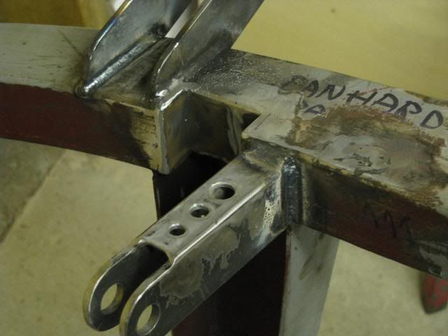

A little fabrication to the front end for spring clearance, Panhard rod fitting etc.

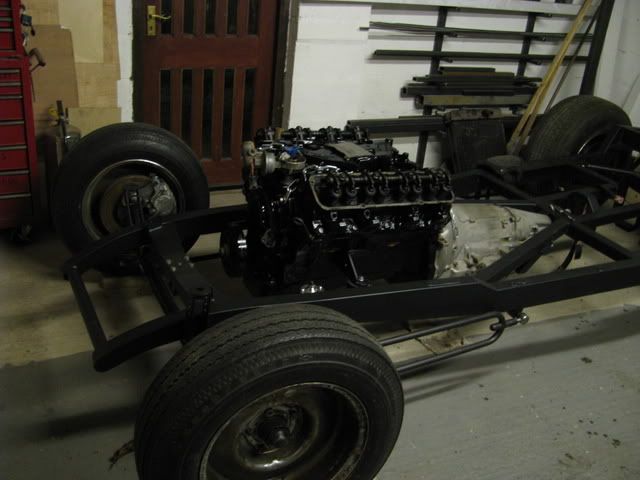

Engine cleaned, painted and back in the chassis.

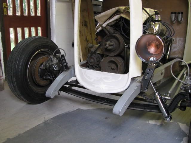

Frond end back in after painting.

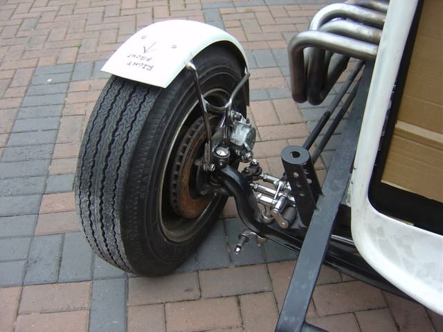

Speedway Vega steering box in on its new bracketry.

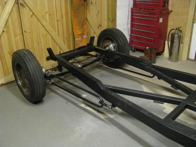

Triangulated four bar all welded up and the axle back in place.

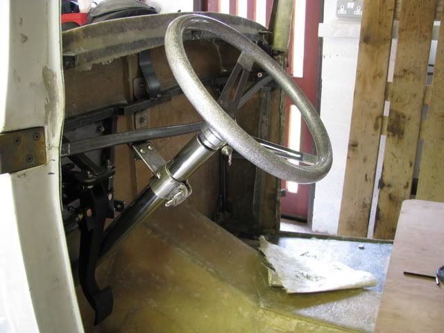

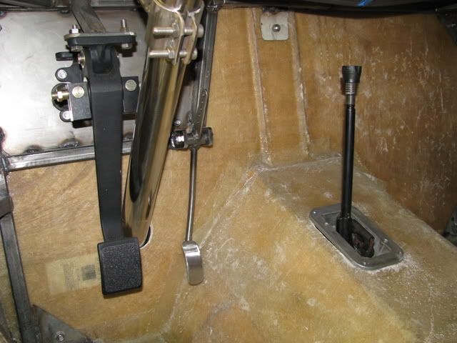

Steering column and pedals have been sourced, or manufactured, fettled and fitted.

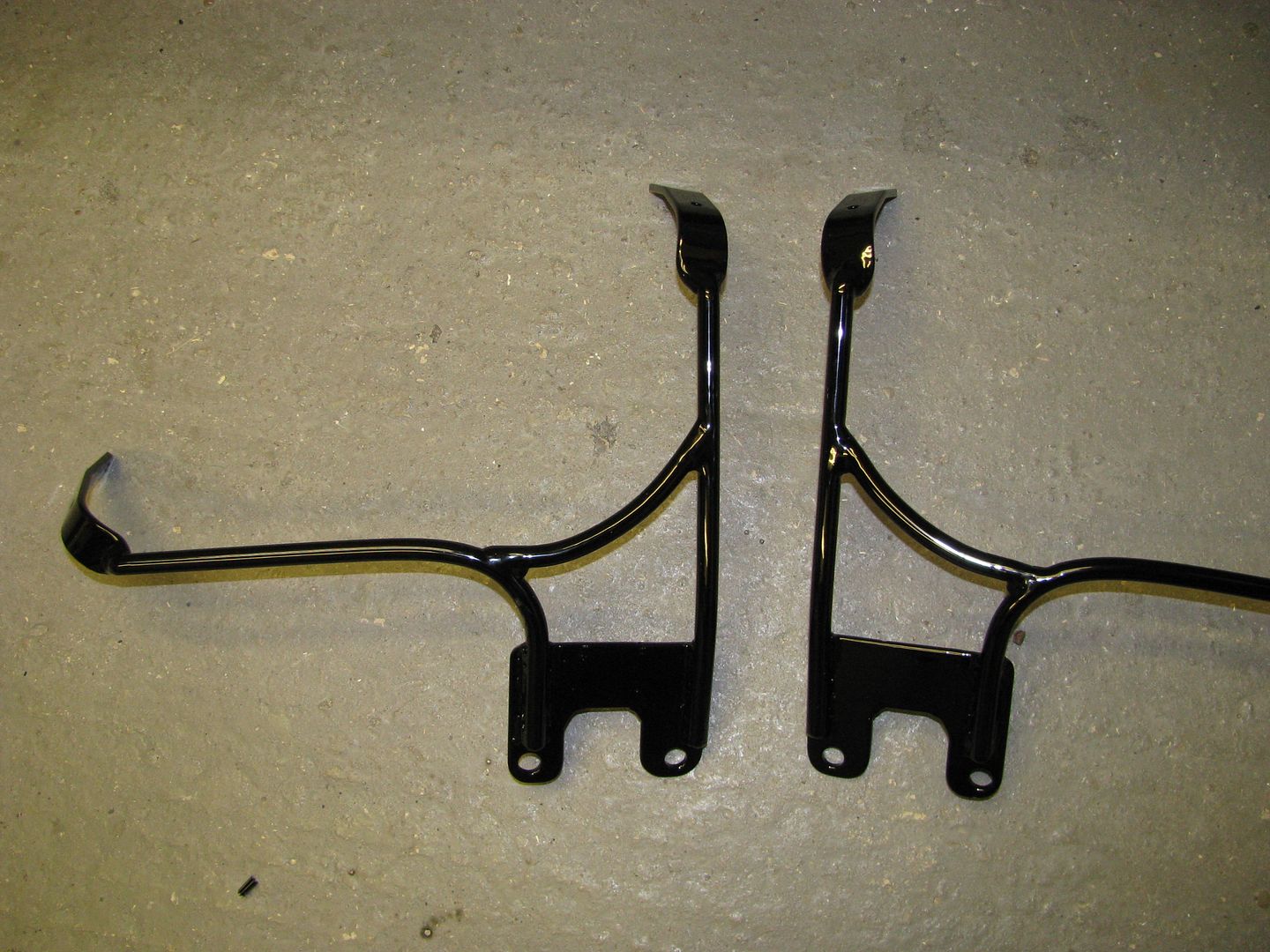

Headlight/shocker brackets fabricated.
Gear shift is mucho modified SD1 auto lever.

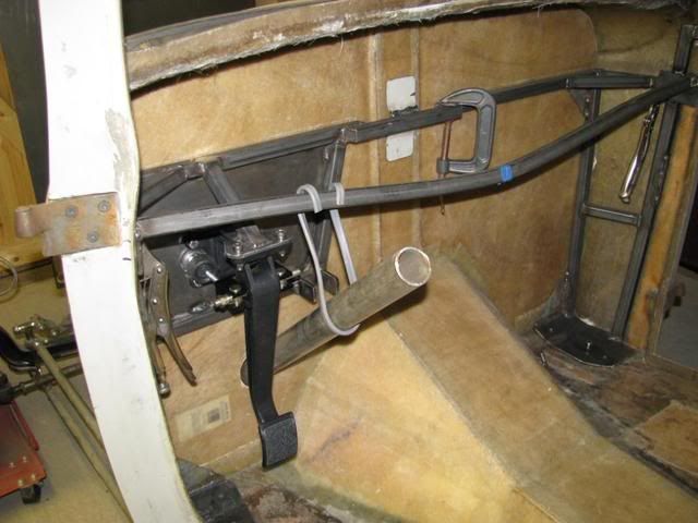

Foot pedal frame has been built, along with plenty of supporting steel for the glass body. Brakes are Wilwood adjustable balance dual M/C's. I invested a bit of money in the important stuff.

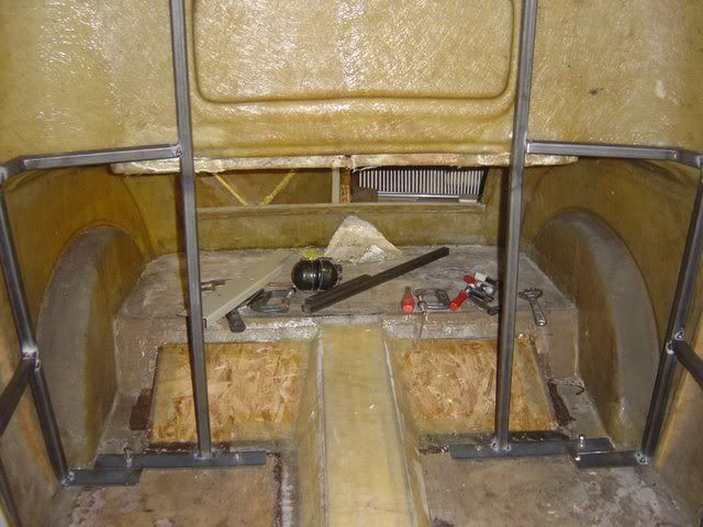

I've added a bunch of steel framework to the floppy glass body.
in hindsight I'd probably have done better just getting a proper 8 point roll cage built, and glass that to the body in places for stiffness. Still, hindsight is 20/20 vision.

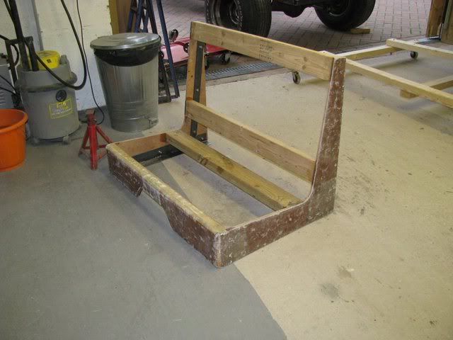

I built the seat from plywood, steel and some fibreglass.

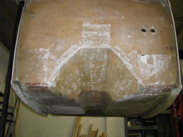

The body has a new firewall and floor glassed in. I actually had the body upside down for a while working on the underneath.

The reason I suggest this is that I went through SVA and it was not a pleasant experience and they will have a field day under your dash!
Example Where your steering column is mounted the bolts for the bracket are on the underside - change this so the bolts are at the front (away from your legs) and then put "rubbers" over the ends so as not to bump your knees on the edges and also the edges of the bracket will need to be rounded to a radius of XXXmm. (The barstewards do check this sort of crap!) Also you will probably need a collapsable boss on the steering wheel - if you need one for the test just say as I think I can lay my hands on one that has done a few cars already!
Likewise your seat looks great but will fail the SVA if it has any part of the seatbelt fixed to it.- From March it will need headrests too! It also need to bolt to a steel floor or crossmember and not fiberglass / wood.

I've built steel into the body framework for the seat belts, as I won't allow my wife/sprog in a car without them.
Bolts under the dash will be replaced with dome nuts and all as time passes.
