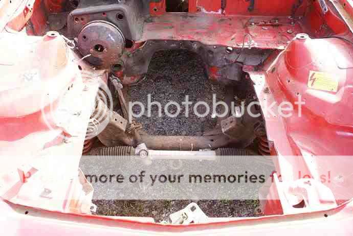

Hi Steel
Cut the flange off on the chassis rsils and seam weld along length.
This will give you an extra 1 1/2" in the engine bay which will help you along the way.
You can also shave the tops of the engine mounts turret which will also give you some extra room for the headers.
Have been down this route with the manta many times with friends cars and my own.
You will also need to find a post 94 Polo servo to make it all fit and a Lucas 9m90 short body starter motor or gear reduction unit as the steering shaft will hit the top of the starter otherwise.
Paul

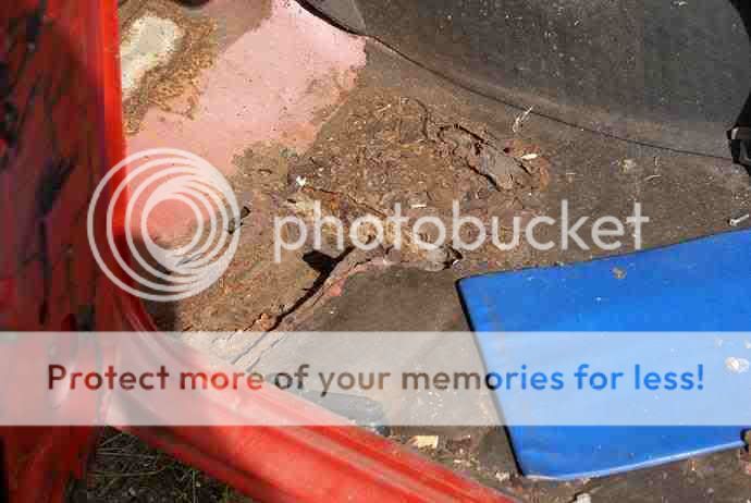

chassis rails are horrible mot patch on top of mot patch not much left of either rail from behind front seat to the frontpanel thinking my only opton is a full box section chassis rail replacement

Hi Steel
The Manta rails are prone to rot but not usually back behind the front seats.
I personally would not cut out anymore than you have to.
The very forward section running to the front panel is narrower than the rest of the rails and is in essence a crumple zone.
Make sure that you take accurate measurements for the chassis outrigger bolt holes as nothing will line up at the front if you cock this bit up!
The section that runs up from under the car into the engine bay is 3 layers thick and this is the main place for tin worm.
If you don't have access to a mandrel bender then I think you are going to have a challenge on your hands with the box section you show in the pics.
If I can be of anymore help then give me a shout.
P

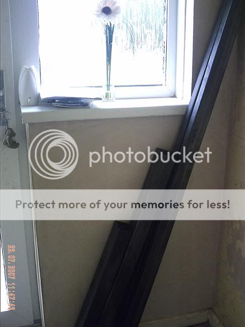

hi m8 what your saying does make sense but ime thinking of modifying the floor and bulkhead as well so would actually be easier as the floor/bulkhead could be bent at the exact angle to suit the rails
anyway made a start
all the tube was mitre cut to length andangle so its spot on
i just need to weld them up now before starting to cut out the old i am going to weld braces/jig in the car to hold the crossmember in place while i remove and replace each rail to keep alignment drilled the holes for the crossmember to bolt to and fitted 22mm o/d steel tubes to stop the box pinching/crushing when the bolts are tightened
