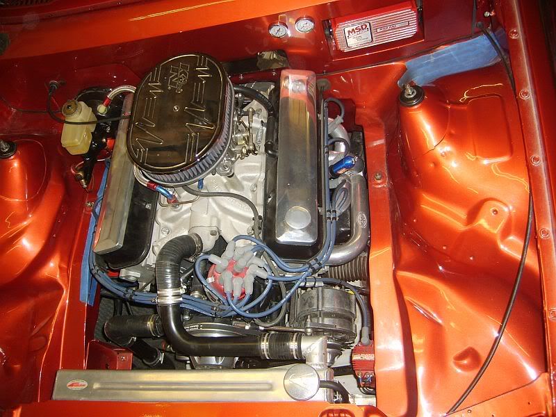

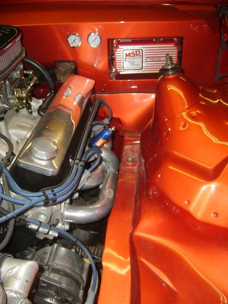

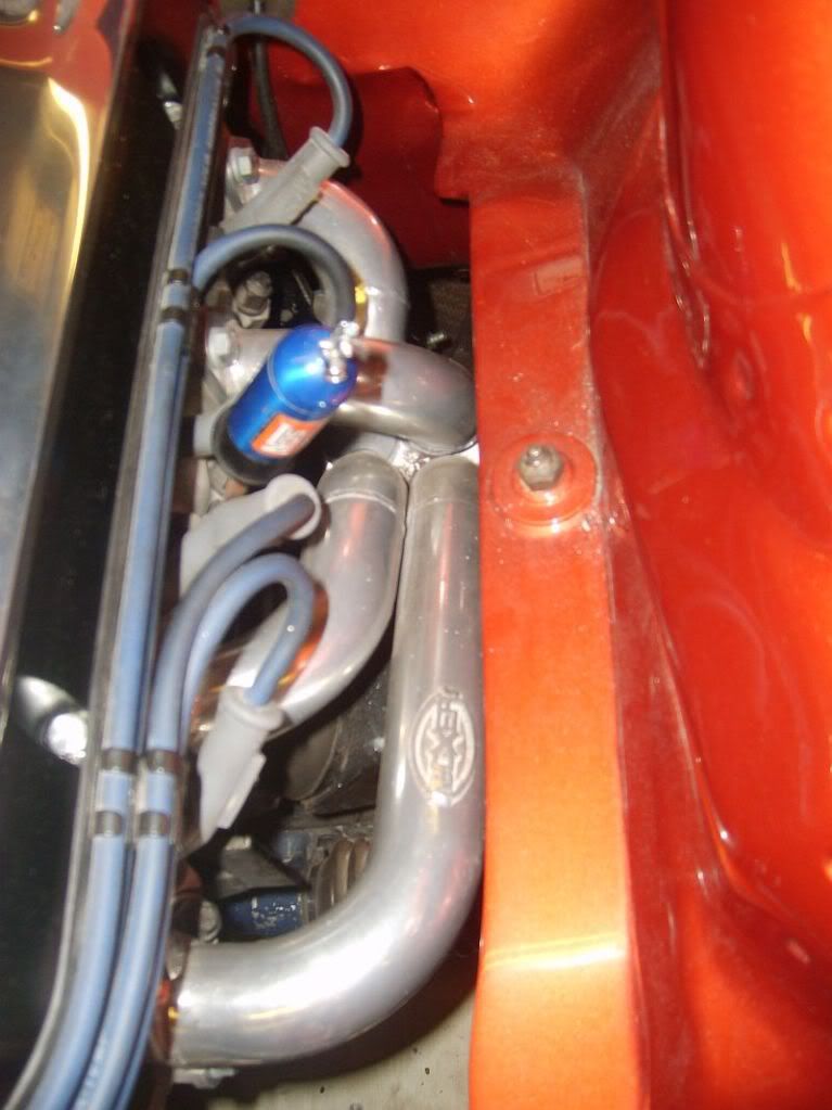

Hi Richard sorry they are a bit big.My wife has loaded these up for you as I'm a pleb when it comes to puters!
This will give you an idea of what to expect from Camcoat if you choose to go to them for the coating process.
Regards
Paul :)
