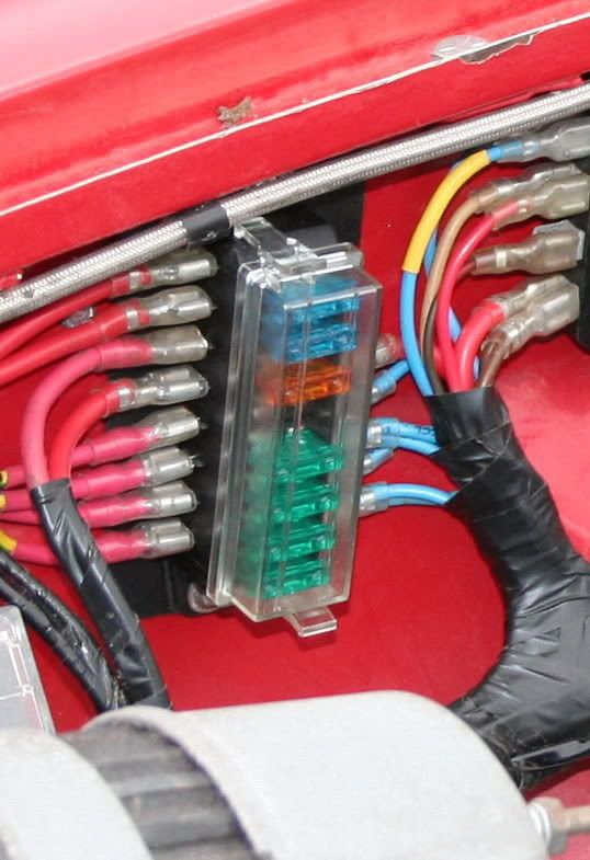

I fitted a few of these fuse boxes about 12 months ago.
The car has been through various weathers and over 1 month on a ship but should I be getting problems already!!
The fuse units seem to have been corroding and I am having bad connections regularly now. I have coated the fuses with Vaseline but still have to waggle them occasionally.
I bought them on Flea Bay!!!
Can anyone recommend a good replacement / fix?

Google Vehicle Wiring Products for all sorts of electrical bits.
Some cheap fuses have very thin blades that work loose and corrode much more quickly.

Hi Dave,
Problem with e-bay for this sort of item is you have no idea where they came from.
For the sake of the cost of a new fuse box and set of fuses it would save a lot of aggro.
You could try Car Builder solutions/ NF Developments don't think they sell cr?p products.

Just looking at your wiring (very neat may I add) you wern't tempted to solder the crimped on connectors were you? I can't really see under the clear plastic shrouds, just with the modern lead free solders onto lead tinned brass spade terminals you can get a right mixture of metals all in contact, this can be a bad thing, electrolesis central. Also some of the modern tin/zync solders can go cristaline very quickly in the wrong envionments.

My problem seems to be the contact between the fuses and their holders. It may be partly down to me as I have commoned quite a few af the fuses and might have done some damage.
I have contacted SVC and am checking their fuse boxes are not the same as the ones I already have.
