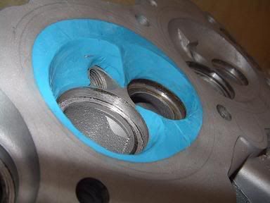

Kev i'm biting the bullet and going for custom pistons. I've had the heads annealed and will be welding up the chambers and cutting in new, much smaller ones myself. For this reason I won't be buying my pistons until the heads are finished - I want to match the dish to the new chamber. Having said that there may not be much of a dish in the new pistons as I have to get the CR up to a level where my cam will function. Using custom pistons also allowed me to run a longer rod. My pin will probably encroach into the bottom ring land with the projected compression height of 1.13" I have to use to squeeze in the 6.125" rods, but thats ok, at least the pistons will be nice and light.CastleMGBV8 wrote:What pistons are you going to use because getting the compression up to abot 9.8/1 is the trickiest bit you really need a flat top but there were none available. I had to use the chevy 305 piston 3.736" 94.89mm which is a flat top but has a 5cc cut out for the chevy valves.HairbearTE wrote:Just read kevs post. If nearly 5mm has to come off then it's a non-starter

That's the first clay model of the new chamber design, it's not very good actually as the walls of the chamber around the inlet shrouded the valve a bit and there's one or two other minor details I will improve upon too. I am of the opinion that taking a little off the head surface is going to give me a better starting point so that is what I am going to do before I get stuck into the heads again.
