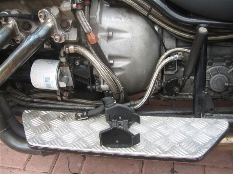

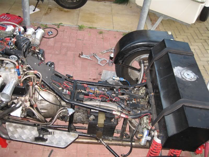

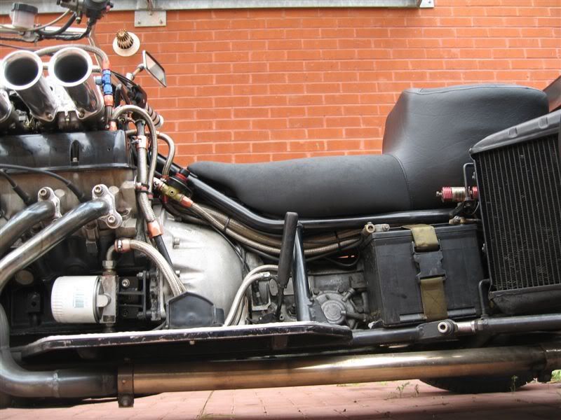

Hiya Chris, where would l find any ID marks..? Heres a couple of pics...maybe it might be obvious to someone what gearbox l have..?
Can anyone tell from them..? Or do I need to do some closer/better ones..?

I can't identify that box - all I can say for sure that it is NOT the ZF4HP22.
But I'm sure somebody else will identify it.......

Thats definetly a Borg Warner 65 or 66 box, u can tell by the servo's on the side of the box, an almost direct replacement would either be the GM180 again a 3 speed box, or the zfhp22 as chris recomeds, in fact i don't think there's that much diffrence in length, just a much larger bellhousing, photos on my webshots if u need a look, john
