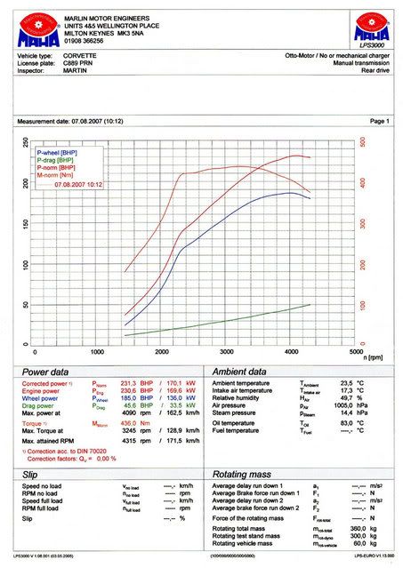

I'm shooting for something a little like this:
If it makes any difference, the car will weigh less than 1000kg hopefully. I suspect traction may be 'interesting' too......
