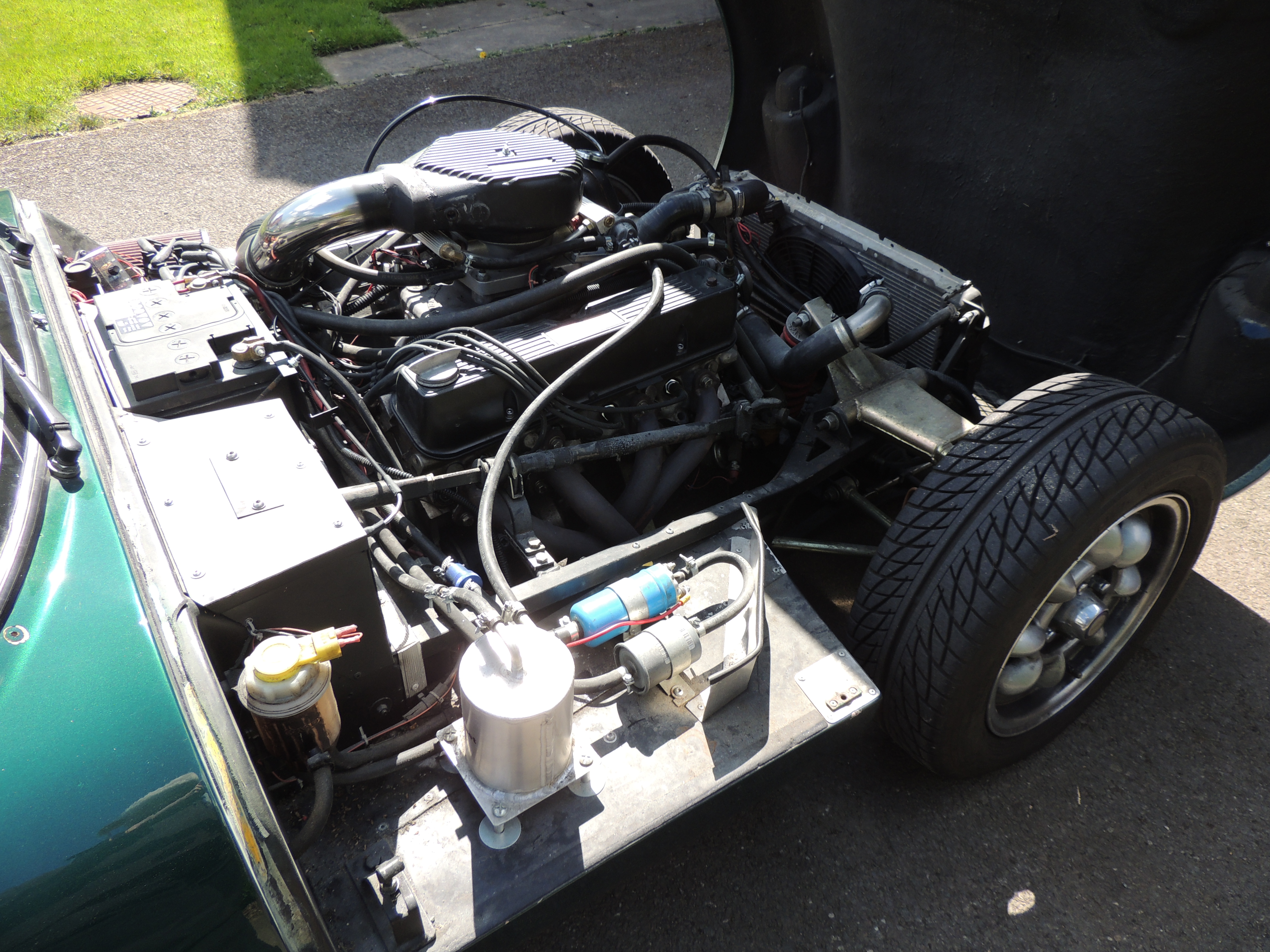

I was doing a 100 mile journey yesterday and my car cut out twice. I let it sit for 5 minutes and it would restart and I continued the journey. After the first time, I plugged in my laptop and caught the second conk out in the attached log at about 3300 seconds onwards.
It looks like pulse width stays normal, but the AFR pegs to the leanest the sensor can do as if no fuel is actually getting injected. Letting it cool for a few minutes (to me) suggests I was getting vapourisation in the fuel rails (or somewhere). The engine coolant temperature looks normal, but it was hot in the bay. I separately recorded that the air coming off the radiator was about 80C and the temperature near the firewall was up to 60C. I have a swirl pot in the engine bay and that was hot to touch (40-50C maybe)
Is my theory plausible?

Possible but I would look further.
What is feeding the swirl at low pressure and the return to tank. The swirl with hot fuel will see Vapor’s and possibly add enough pressure to stop a low pressure pump which in turn will cause the HP pump to suck air.
This happened a couple of times in my Gt40 made worse when first on the road and fuel filters that got clogged helping slow the LP fuel circuit. Clean filters, easier bends on the fuel hose lines and it never happened for years…..then reared it’s head again at LeMans 2016 where the day temp was up around 45 C
A stop for 5 with engine bay open and off I went again.
BAD THING is if this is the problem then the HP pump has had air when running and that will fail in short order or get very noisy.

Thanks, that makes sense as it occurred at a time of a reasonable spell at 70 so if LP wasn't feeding, the swirl pot could have drained and then refilled when I stopped. I have a restriction in the line back to the main tank as I was led to believe the LP pump needs something to work against. It's (I think) a small diameter welding tip end.

I don't have any spare inputs on the ECU, but I've got an ESP32 doing logging duties and I can merge that with ECU logs with a little extra work. I haven't managed to find a fuel pressure sensor I can easily integrate (yet), but I'm going to add some temperature sensors to the fuel pump, the swirl pot and the fuel rail to get an idea of what they are doing. The HP pump could well be suspect. I replaced it a few years ago because the previous one was making noises it shouldn't. If this one is on the way out, I may have a more fundamental problem that is using fuel pumps like fuses.
