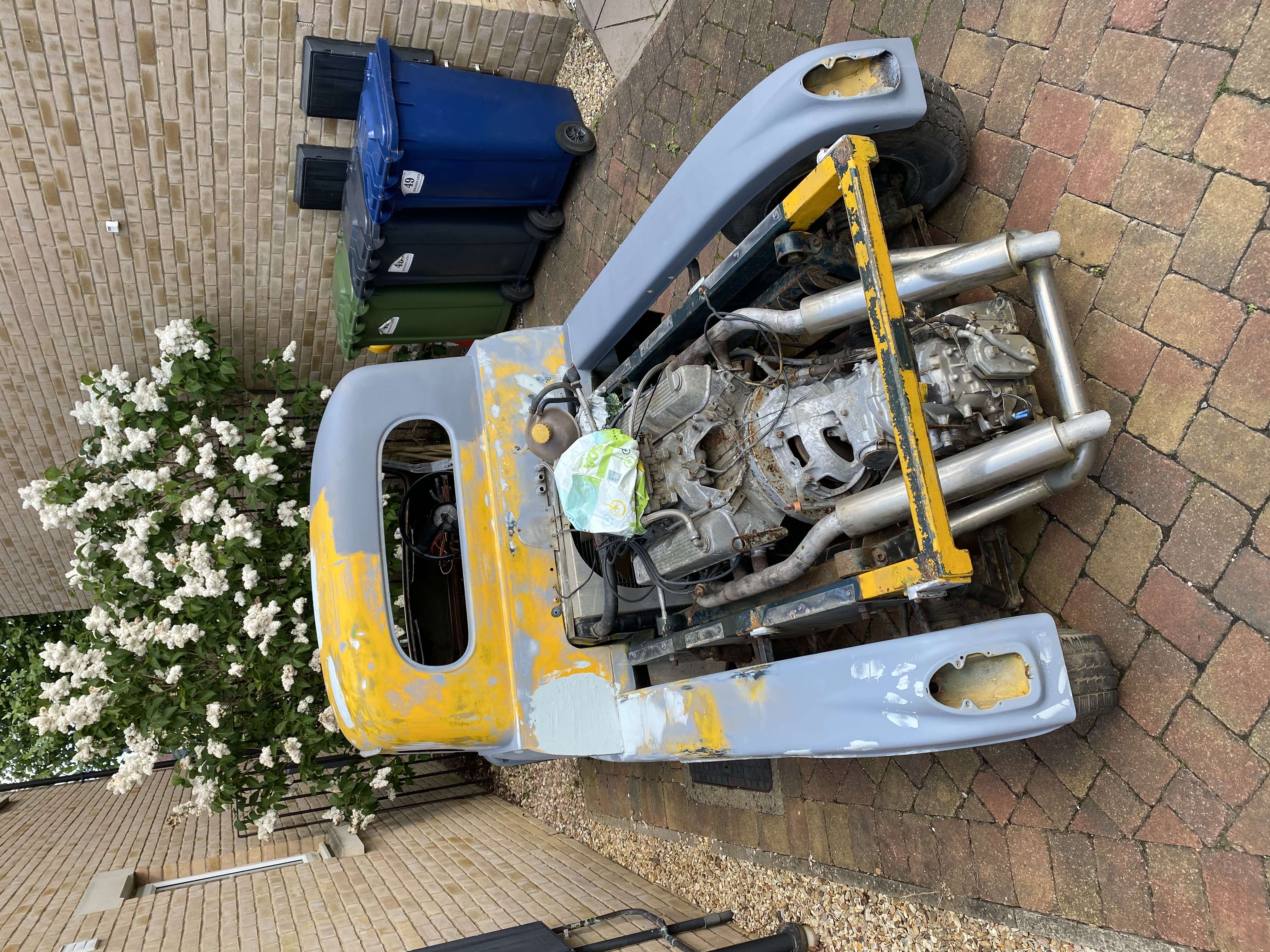

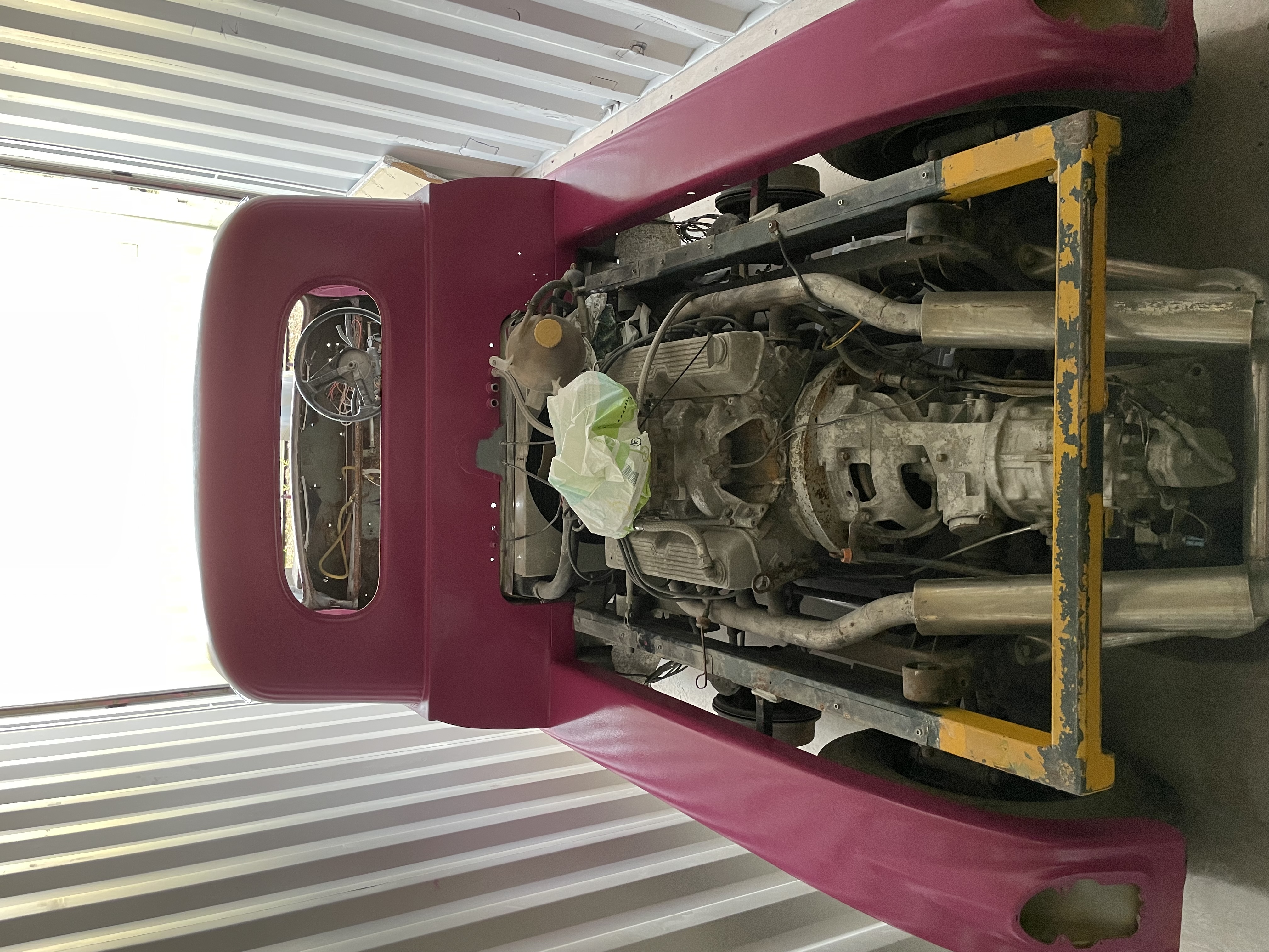

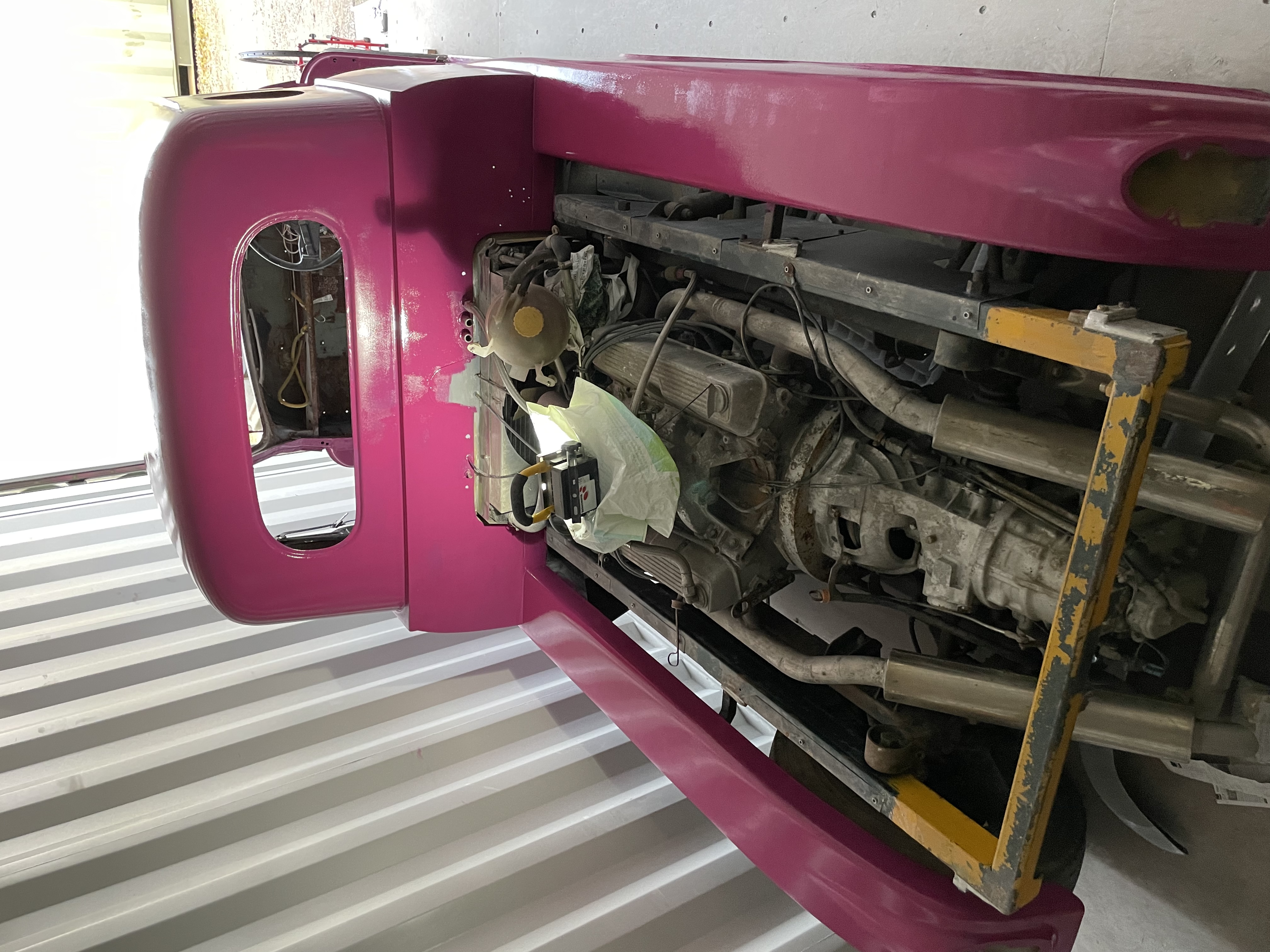

Sorry I’m an absolutely cluesless person about this and without the right pictures (which aren’t working) I can explain it very well.
The engine is mounted facing forward. I’m not 100% what transaxle is, but the driving axles do come straight off the transmission as such.
I know nothing about differentials or bell housings.
Im more looking for, if I was staring from scratch does anyone have any ideas what would work.
I’ll get pics that show things better.

Re: Ideas for a auto gearbox. RWD rear engined 3.5 v8
ok, so it's just a simple 2wd box you need ?
And yes that style is a transaxle.
Cars like Audi A4's, VW Passat around the late 90's and early 00's used them in FWD configuration so would be an easy bet.
Usually referred to as an Audi 01E, although that can come in other configurations too.
Renault was another popular choice for kit car type things years ago too
viewtopic.php?t=3477
I think it's this seller is a UK maker of some conversion kits.
https://www.ebay.co.uk/sch/34651812/m.h ... 3561.l2562
edit...should add though, the above I mention are manual boxes. But fitment wise from the same vehicles should lead you to autos. Although getting something old enough to avoid modern electronics might be harder.
No idea if late 90's is old enough ?
https://www.ebay.co.uk/itm/303313146844 ... SwZHxbfFQU
I would definitely stick like for like with that! Clearly a lot of work has gone into making it all fit etc. etc.
There was never a factory transmission like that for the Rover V8, so there is no 'easy' solution other than to stick with the same.
