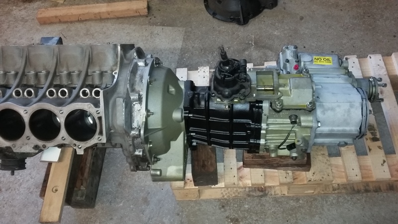

Yeah, I put a Thor engine in my Land Rover, coupled to an R380.
I used Tornado Systems to alter the ECU to a 'standalone' system. The wiring is still complicated - so I did a drawing which I gave them.
Note that you need the right ECU to start with - I think a Discovery II ECU (they will tell you).
You can get flywheels made to suit your Thor + manual transmission. That's easier than trying to find a factory flywheel.
You can fit it straight to an R380 if you use the R380 from any Land Rover product. However the bellhousing is very very long.
I wanted the shortest version possible, so I used an adaptor ring to take it to the Land Rover 4 cylinder bolt pattern, then the 'stumpy' bellhousing from Ashcroft Transmissions.
The clutch is 9.5" though.

So this is going in a Spitfire? so RWD? in which case P38=4WD R380 and 2WD R380 are quite different and not interchangeable - You would need a 2WD R380 from a Morgan (rather rare) and maybe was in a Sherpa Van? but with too low gearing, or an 2WD LT77 (I have one spare if you interested?) from an SD1/Morgan/TVR etc..
I would think will be easiest to find an engine/box out of a crashed TVR - these used a Tremec T5 in the later versions, LT77 in the earlier versions.
I modified my GEM's inlet to bring the inlet round to the front - rather than side for bonnet clearance.
