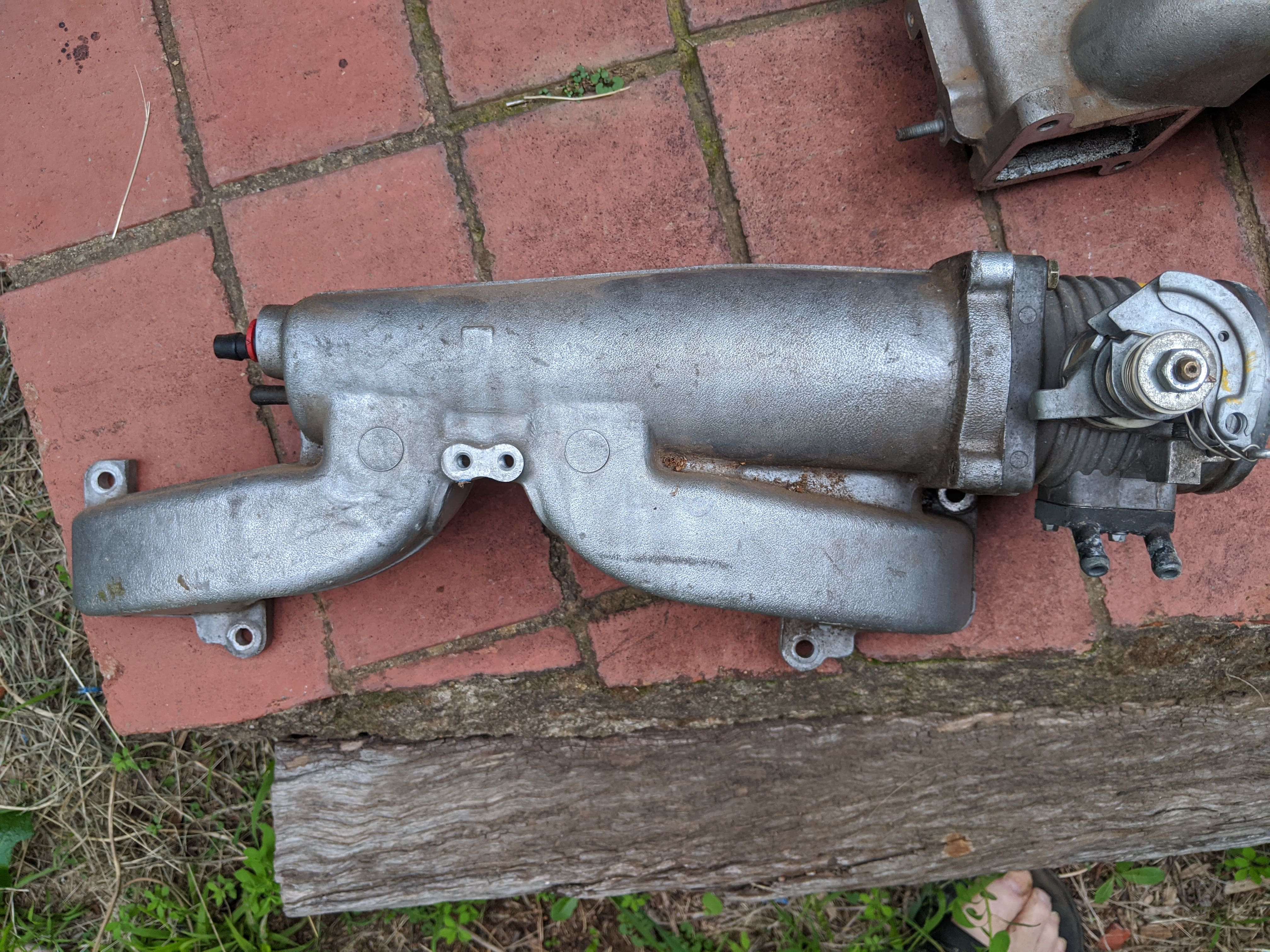

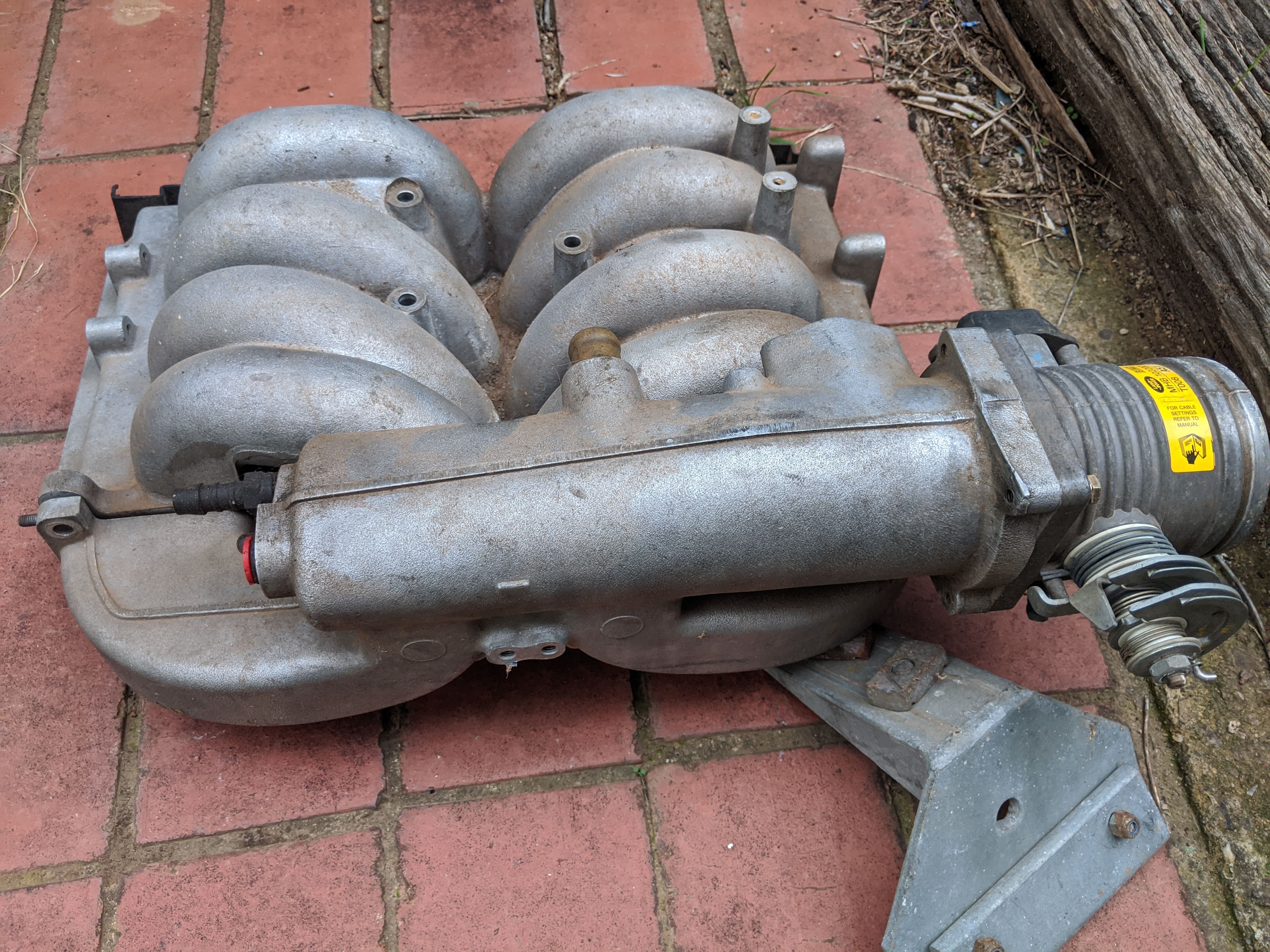

The intake plenum on a Thor RV8 is a "bannana" style with each side joined at the front with a cross pipe with the throttle body on on end.
This pic shows the cross pipe with the throttle body on the right.
You will note that the cross pipe has a larger diameter on the right and a smaller diameter to the left. I would have thought the cross pipe would have had the same diameter all the way across. Does anyone know why in theory air would be restricted a little to one side of the engine.

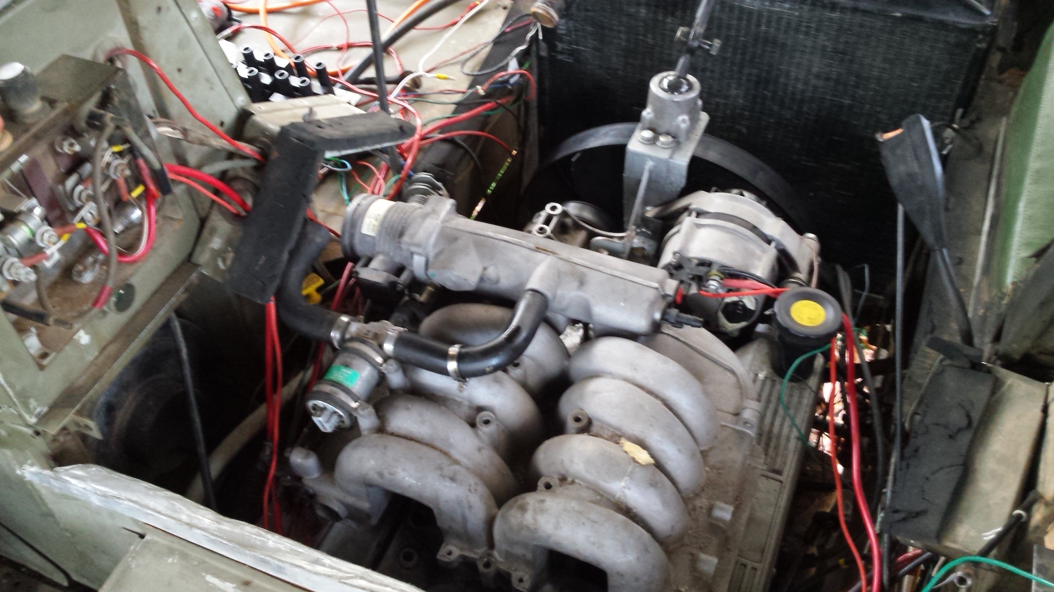

The reason I ask is that in my 101 engine bay there is very limited room on the passenger side and it would be good to have the throttle body on the left (drivers side) and putting it on the left (cutting the end off and welding on a throttle body mounting plate) but the inlet will be reduced in diameter.
As an alternative I could cut the right hand side of the cross pipe about 3" to the left of the throttle body and mount the throttle body there but I am not sure on what impact this would have with a shortened cross pipe.
Any throughts from the engine induction specialists? :)
This is a pic of my engine bay and you can see the right hand side has much less clutter.
Garry

Educated guess, but I'd think it is to maintain velocity of the flow after the air for the right hand cylinders has been consumed.

scudderfish wrote: Fri Mar 13, 2020 7:54 am Educated guess, but I'd think it is to maintain velocity of the flow after the air for the right hand cylinders has been consumed.
Thanks for that - makes a lot of sense - I appeciate the thought.

thor manifold would be the best bet in a 101, gives more torque than the gems and previous hotwire plenums.
is it not possible to rotate the the thor plenum 180?
or get an elbow fabricated to rotate the throttle body 90'?

Easiest option as Eliot pointed out is to put a 90 degree elbow between the manifold and throttle body. It still on the same cluttered side but has more room.
If you need more space, cut the manifold flange off and weld a 90 degree elbow on the manifold. This moves the elbow towards the center.

Eliot wrote: Sun Mar 15, 2020 4:55 pm is it not possible to rotate the the thor plenum 180?
No it is not possible to turn the intake runners around 180 as the runners will not line up with the holes in the lower inlet manifold.
However I had not considered taking off the throttle body and putting in a 90 degree bend - good thinking I will look at that 8-)

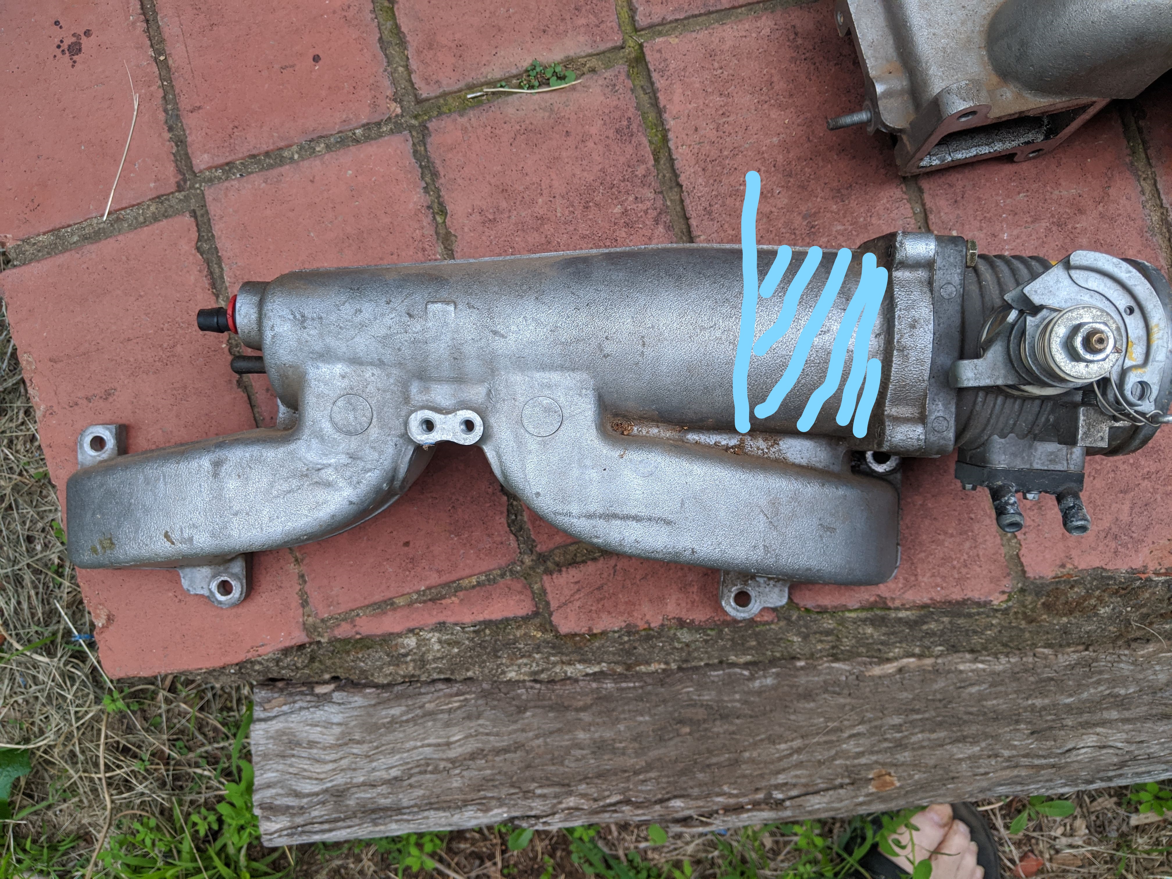

minorv8 wrote: Mon Mar 16, 2020 5:36 am If you need more space, cut the manifold flange off and weld a 90 degree elbow on the manifold. This moves the elbow towards the center.
Like this - removing the blue shaded area??
Yes - thinking about it but a 90 bend might be a good option 8-)
