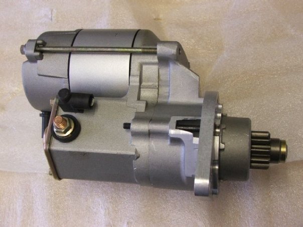

My SD1 had the later 'small' Lucas motor. Which did seem to struggle a bit on a cold day. When that failed, I went for a Hi Torque type. Which does seem to spin the engine over at a more consistent speed regardless of temperature.

+1 for the high torque starter. It's a weight saving as well.

hi torque one on mine too

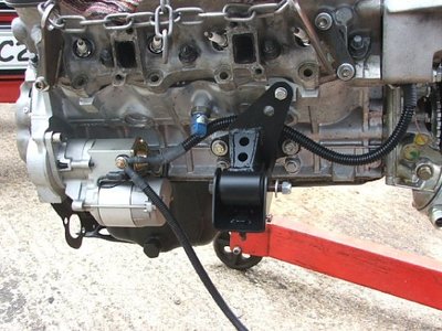

Hi-torque on mine,tiny and light compared to the original

I have my old 24v OEM starter off my old 3.5 on my new 4.6 Hi Comp and it has no issues. If the OEM starter is in good nick it will do the job OK.

WOSP High Torque fitted and vast improvement. Cost me £120 from Demon Tweeks.
