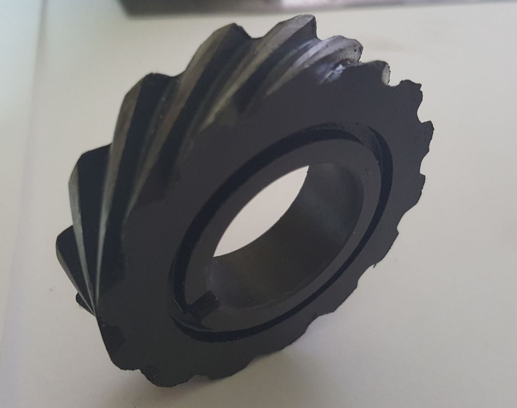

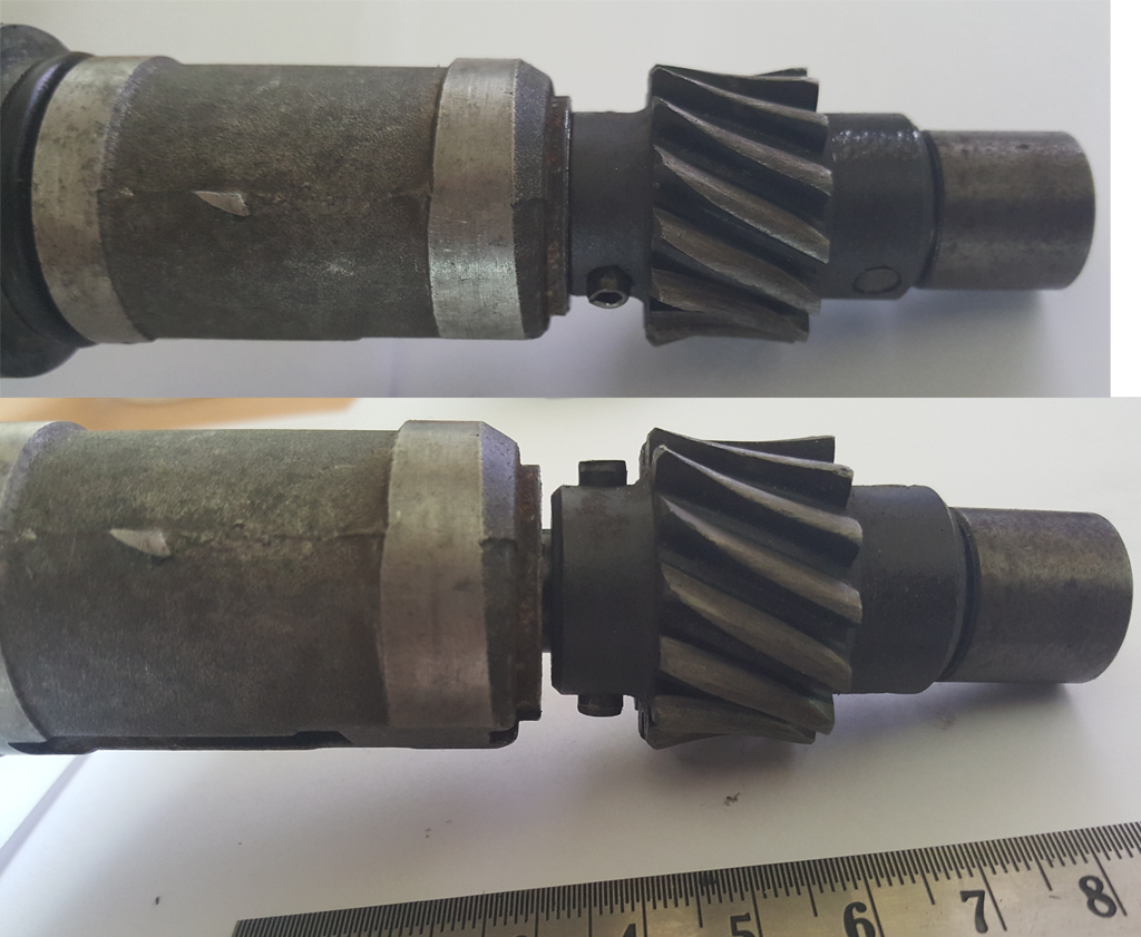

I took the distributor out and noticed that there was about a 1mm vertical play in the shaft through the housing:
You may also be able to see the gear was slightly worn. I took the timing cover off and the teeth on the drive gear seem to be pretty stripped:
So, the question is: Is this a cause of the lubrication problem? Or would it be the consequence of the lubrication problem? I'm happy to buy another drive gear but I don't want to fit it just to have it destroyed the same way. I've also ordered an interim timing cover and water pump, but was hoping that upgrade was a way away since it requires the crankshaft to be removed and engineered to fit a larger woodruff key (so I've read).

I think you need to strip the engine and have a proper clean and investigate. Do you have a high pressure oil pump relief spring in the pump? Did it have the correct oil filter? One that works with the rover bypass? Has a foreign object got jammed in the oil pump? Are the oil galleries free of blockage. Something has caused the rapid wear of those gears, this is often as a result of extra load from the oil pump from increased pressure or restricted flow hence my questions, however it needs proper investigation.
The description of the distributor not turning means the oil pump has also not been turning, this has serious implications for main and rod bearings so they will need investigating. The teeth on those gears have been turned into metal swarf, that in turn has got into your oil and back into the oil galleries so the engine will need a proper clean. I would have a good look at the cam lobs and tappets because they usually suffer very quickly in the event of swarf in the oil and reduced oil flow.
Sorry to be a misery guts but if you just replace parts without cleaning the galleries then you will just make more swarf.

The thrust when running pushes the dizzy gear upwards. The play might be caused by a worn plastic washer on the other end of the dizzy shaft which isn't really needed when running - many stumpies don't have the shaft secured at the top at all.
I'm surprised the gears were 'jumping' - even when worn. Unless teeth are totally missing. Are you certain the dizzy was located on the oil pump drive and fully home?

The teeth on the drive gear look pretty flat compared to images I found through google. I'm pretty sure the dizzy was located correctly - the lip on the housing was right up against the block and the bolt was fully tightened.

This is a fairly common problem at high RPM and or excessive load. We fitted an oil feed pipe from the pump cover to spray into the nip between the gears, this was a fairly common mod in the rover V8 drag race series days, there used to be an off the shelf kit for it, don't know who made it as we made our own.
Alan
Yes - I've read lubrication can be a problem if you raise the rev limit.
But never seen wear that bad even on a high miles standard engine.
So would guess the normal lubrication system is faulty in some way? Which would need sorting before replacing the gears?

Did you check that the cam key was parallel to the cam axis when it was fitted? If not it can restrict oil to the distributor drive gear.
Did you have the cam gear spacers flange facing forward & the cam gears oil groove facing it? Again this can restrict oil flow to the gears if you get it wrong.

Those gears haven't worn like that in a short time. IMHO, there's been an ongoing lack of proper lubrication for ages.
That looks a bit odd to me. The dissy drive cog should not be worn like that? The cam cog can wear down in quick time as I have had a good few let go and cause the dissy to jump teeth. From my own experiences the dissy cog remains ok while the cam cog can wear so far that it lets the dissy cog jump a tooth on each rpm.
