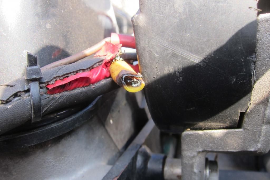

Got home, looked at the alternator, inspected the live lead and it fell off...
That's what's left of the spade connector - the rest is still on the alternator.
So I was basically lacking spark power - and all my plumbing work involved lots of starting and stoppong the engine, which lowered the battery, which increased the problem!
