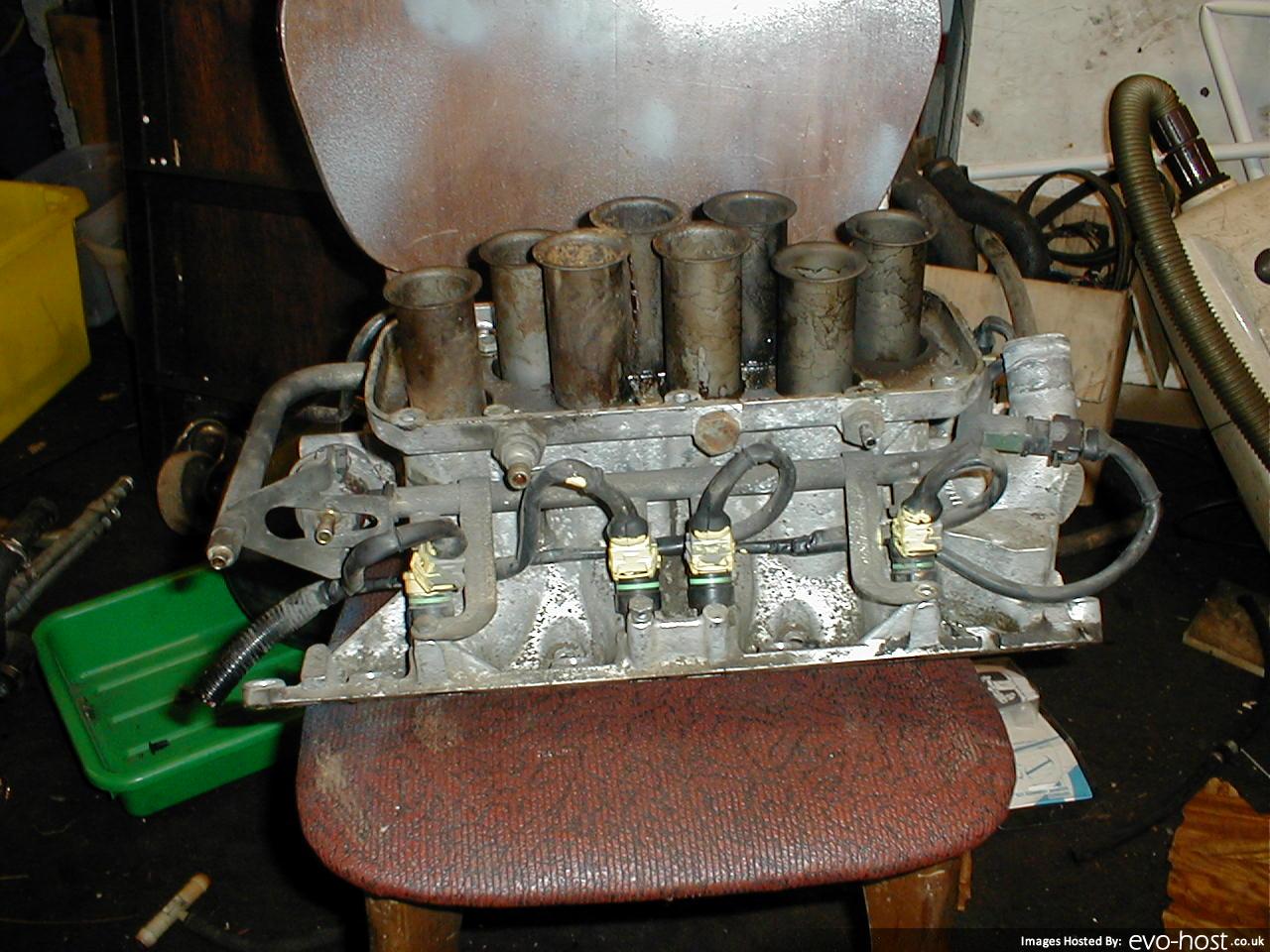

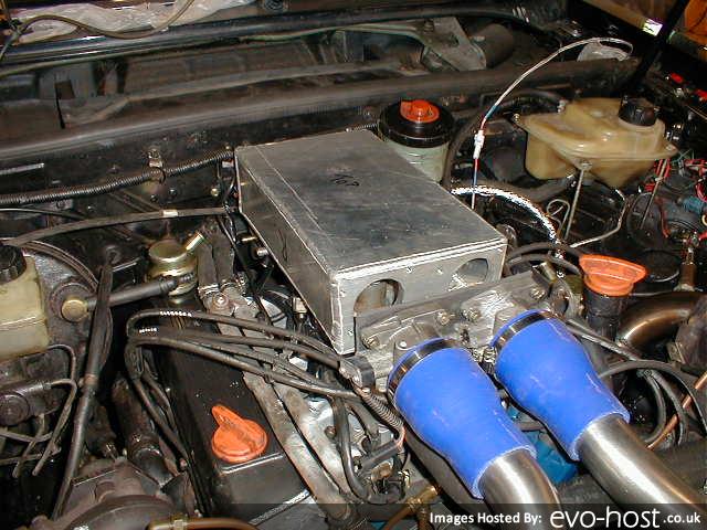

Dont worry about altering the length, boost will sort anything out.
I did this years ago with mine, think I removed a good amount
Original
Shortened
I think I also had the base manifold shortened a few mm too. Although there are limits there before it starts hitting fuel rails etc
I then just made a crude alloy box to bolt on top. I only used two throttle blades because it seemed easier at the time and I had two lying about.

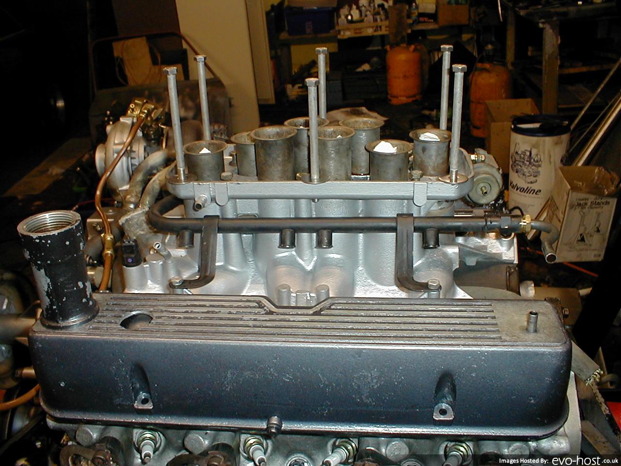

I took 25mm out of the plenum base, by machining both top and bottom faces.
I also cut down the trumpets.
Just do some careful measuring!
Some photos here:
