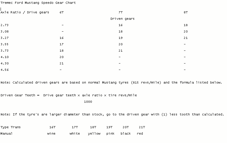

Can anybody tell me the number of teeth on the speedo drive inside the 'box. Not the removable drive wheel, but the one that drives it. I need the number so speedy cables can sort my speedo out . Thanks in advance, Bill.[/i]

This may help

Thanks for your help, Kev.
