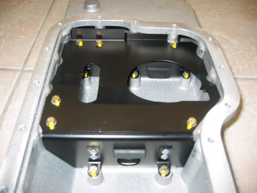

I manufacture wet sump pans for the E30 M3, these are basically an evolution of the original DTM sump pan. I use the rubber flappers (available from BMW or Cosworth) instead of the metal "trap doors" as they are more reliable IMO.
Basically you want to build a sealed box around the pickup,about 1 litre capacity, and the rubber flappers will allow the oil in (but not out) Once you have finished building it, pour in 2-3 litres of water (about the same viscosity as hot oil) and tilt it side to side, and front to back. This gives you a good idea of what the oil does under acceleration and braking, and cornering. It also shows you if the oil is leaking past anywhere, you want it to retain as much oil inside the box as long as possible.
It is not that hard thing to achieve a wet sump system that will support decent cornering speeds (mine work on very high G corners with slicks and no oil surge)
Heres a couple of pics of the inside of one of my pans to give an idea.
Conrad
Conrad
